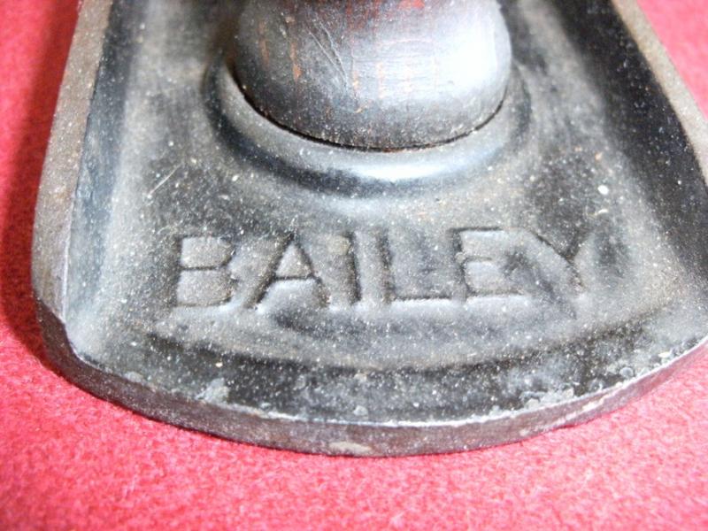

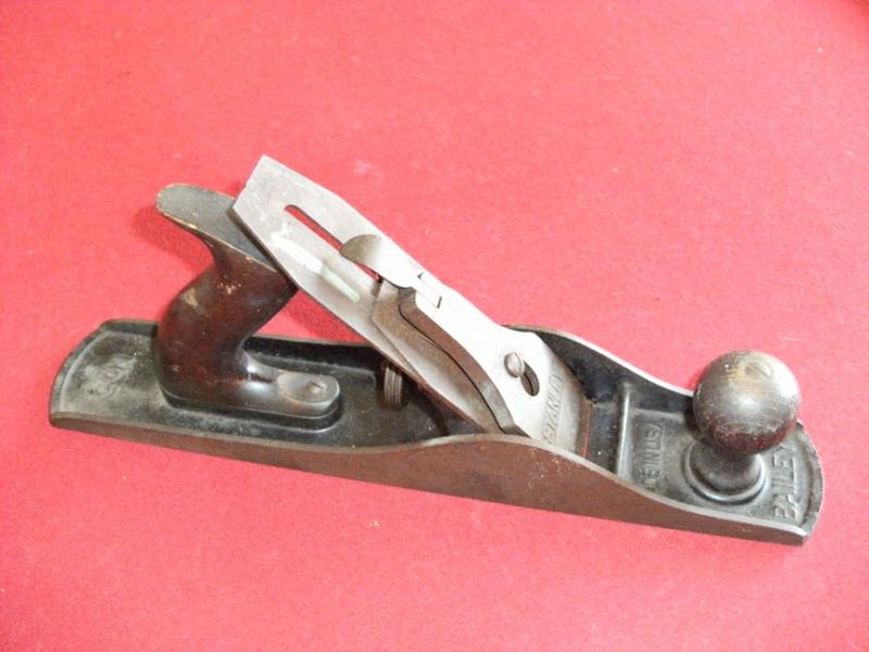

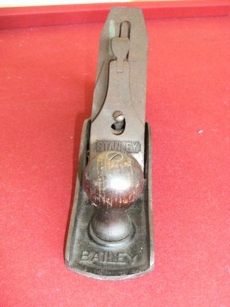

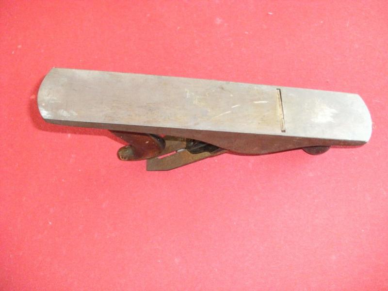

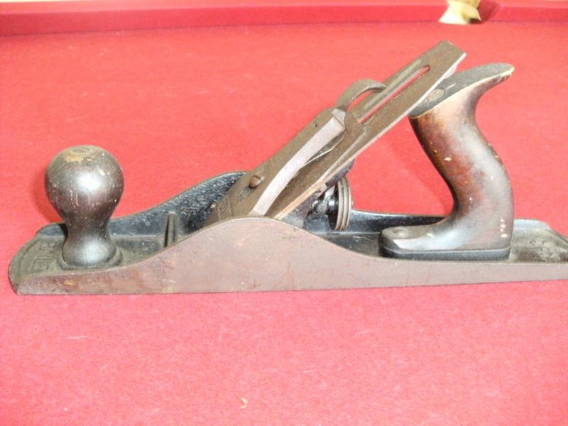

The main point of this post is to glean some info from my elders. A couple weeks ago, my wife and I spent 5 days running around the N, Georgia mountains visiting obscure antique shops and little hole in the wall eateries for our 11th anniversary. We came across one antique shop in Blue Ridge (i think) that had at least 3 of everything know to man. I stumbled on an area that was loaded with old, rusted, beaten hand tools. Well, this one bench plane caught my eye and I swear she was giving me that look...you know the look...the one you get from the lonely dog at the pound that could melt a hole through steel. So I picked her up and started going through the mental checklist of what you should look for. Missing pieces, broken this or that, dents, chips, cracks, etc. I couldn't really find anything that was bad enough to make me toss it back. The tag hanging off it said $45....I though that might be a bit more than I wanted to pay for an old plane...then I saw the "everything in this section 40% off" sign! Well, my decision was made by this point.
I decide I would try and restore it to it's former glory. I've watched just about every video I can find and gone through article after article by hand tool wizard Joe Schmoe, or plane expert What'sHisFace, but I wanted to post it to my fellow IAPers in hopes that someone has some advice on stuff to watch out for. Or simple fixes that make a big difference.
Also, if anyone out there knows the estimated value of this thing, that would be great too. After several days of researching, the closest I can come is that it is from the 1880s-1920s. Not sure how much truth there is to that, so maybe someone here can help me out with that too.

Scot, from what I can see in the photos, I would have jumped all over her at the $45 price. That plane is in great shape for its age. If the base is not warped beyond repair, you have a cherry in hand. Take her apart, clean up and reassemble. Sharpen the iron and do the adjustments needed and that tool will serve you for many years to come. Congratulations on your find.

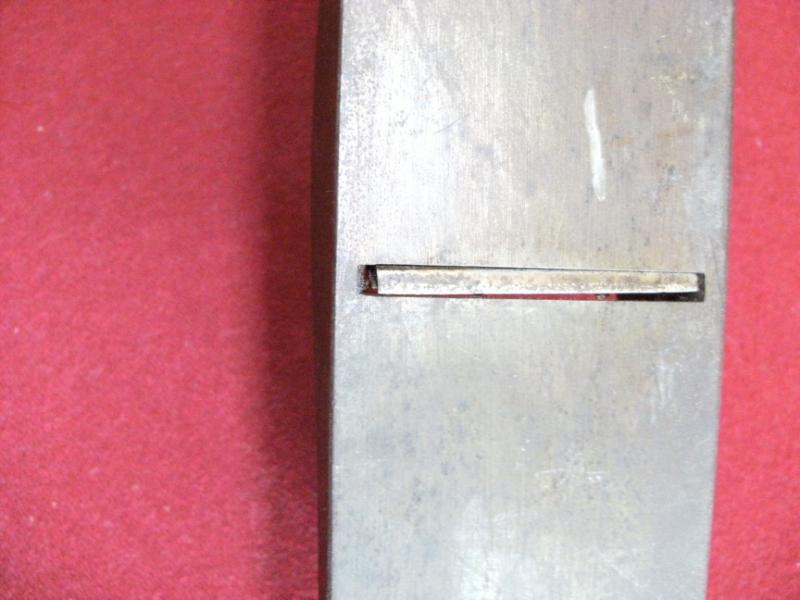

looks like a good servicable plane.
Take a piece of glass and tape a piece of fine grit sandpaper on it. slide the plane (without the blade) across it a couple times and look at the bottom. What you want to see is that the sandpaper was riding the outside edges or the entire sole. This means the sole is either flat, or slightly concave in the center. what you don't want to see is the sandpaper riding in the center without hitting a portion of the edges. Meaning the sole is slightly convex.
Some say that you need it completely flat, I disagree and say as long as it's hitting all the edges its good enough. If its convex at all, then you could be in for some hours of sliding on that sandpaper to flatten it.
Other than that. Learn to sharpen and set the blade and start making ribbons.

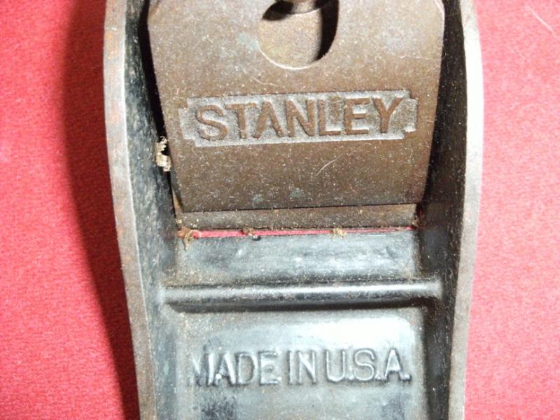

I am addicted to stanley planes. Here is a great resource for dating them:
http://www.hyperkitten.com/tools/stanley_bench_plane/start_flowchart.php

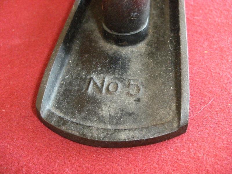

Based on the pics, I would say Randywa is pretty close. Here is my rational
-raised ring under the knob
-kidney shaped hole in lever cap (that was added post 1933, IIRC)
-rib in the casting at the toe and heal
No 5 planes are pretty common, $45 is probably fair. Getting it for 40% off, and being in good condition was definitely a good deal!

to flatten the sole (bottom) of the plane, buy yourself a 6 inch wide by 3 ft long piece of 1/4 or 3/8 plate glass. Then buy some adhesive backed wet use sandpapers starting at 320, 400, 600, 800, 1000.
place the grits on the glass, side by side, and use this to progressively flatten and polish the sole. do not advance to the next grit until the sole has the same sheen (consistent scratch pattern) accross at least 80 percent of the sole. Also, make sure that the toe (front of the bottom where the small handle is) is 100 percent abraded. The back 20 percent can be not fully covered, as it is a follower area, and the front is the most important part of the sole.
One of my prized possessions is a toolbox (about 1' X 1' X 4') that I inherited from my Grandfather through my Dad. In that box is almost all the tools my Grandfather used for building houses and cabins in the Houston area during and following the Great Depression. Among those tools is an old plane almost identical to the one pictured above.
One of the first things I did with it when I got it home was to test the sole for flatness. I colored the entire sole with my old black boot polish and slid it across a sheet of 600 grit sandpaper glued to glass. Applying as little pressure as possible I slid it back and forth only once. All areas showed signs of abrasion. About 5 more passes (10 up and back) there was no black left at all. No areas were overly shiny like they had more contact than others. Next, I put my square on it to make sure the sides were 90* to the sole. As far as I can tell everything was good.

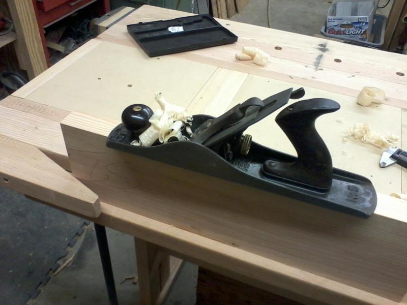

That #5 is a great starting point. They can be set for very coarse flattening work of very fine work. Heres mine after I recently sharpened it. BTW- a little wax on the sole will help them slide a lot easier.
