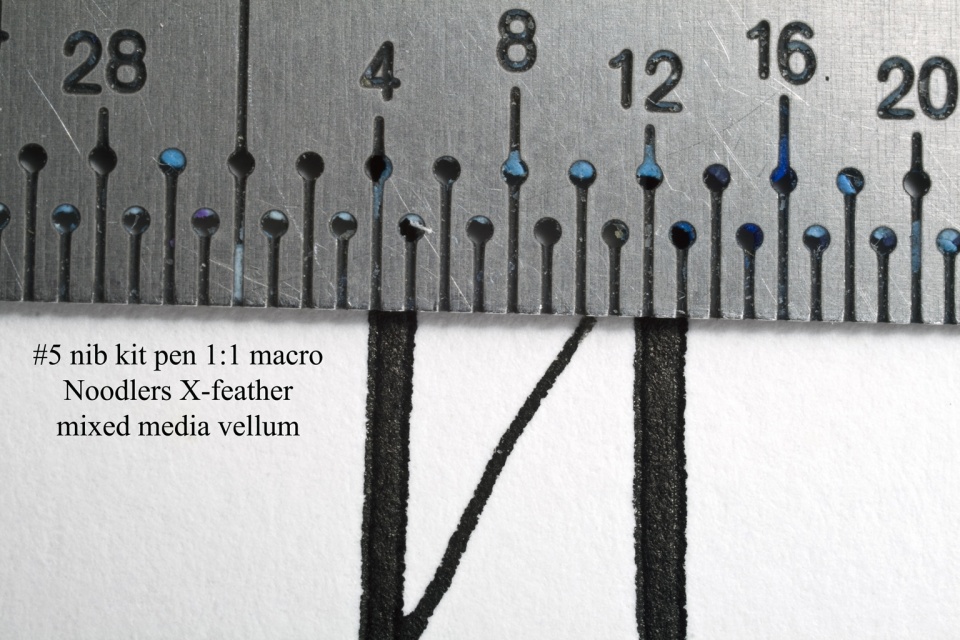

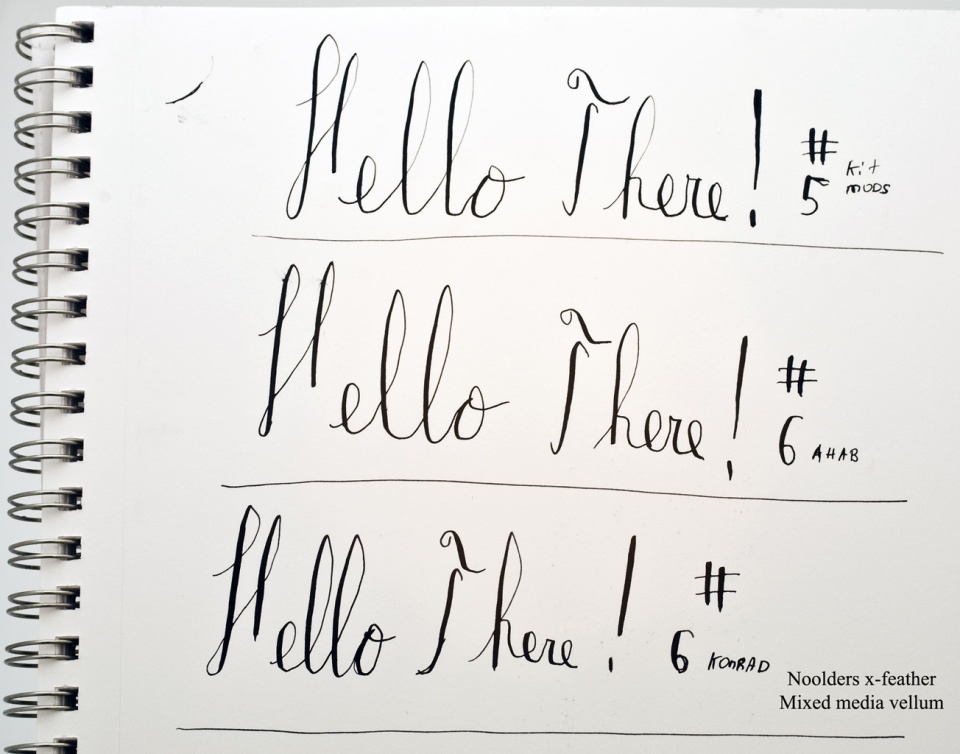

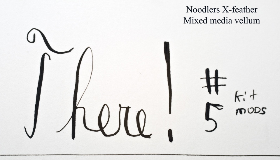

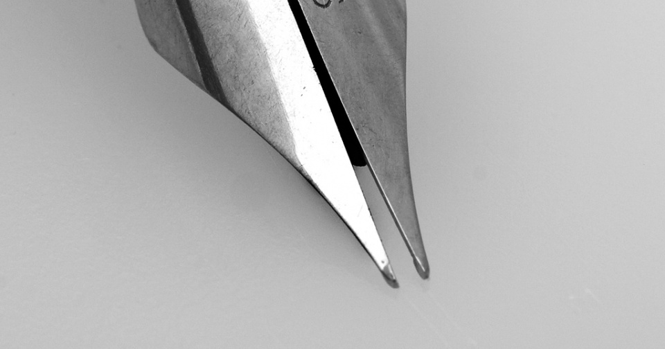

I took these shots earlier. This is a kit pen that I did some heavy mods to and dropped in a custom nib. I am still doing tweaks to the feeder as all the kit pen feeders are like a desert and you can clearly see some feed problems in the image.
attachment.php
That's 1/32" wide lines you see in the image.
attachment.php
This was compared to #35 nibs on 2 flex pens that I have. It's not as good as the #35 nib size but that's is a whole new topic for another day.
attachment.php

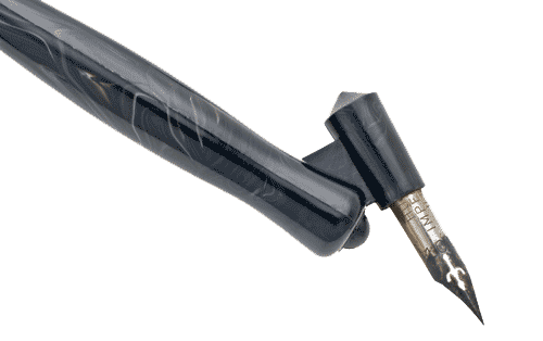

If he wants pointed pen calligraphy, he has two options. The first is expensive. Get a nice gold nib, 14k or 18k, and then get a custom grind done by someone with serious nib experience. Mortishaw, Binder, the like. The other option is to stick on a holder that will allow him to insert a variety of dip nibs, like attachment (though it's an oblique holder, that can be attached straight as well).
I definitely do not recommend getting a dip nib stuck on there permanently, as they are cheap and meant to be replaced as soon as they lose their fine point. Here are some examples (my work) of both broad pen calligraphy and pointed pen.
