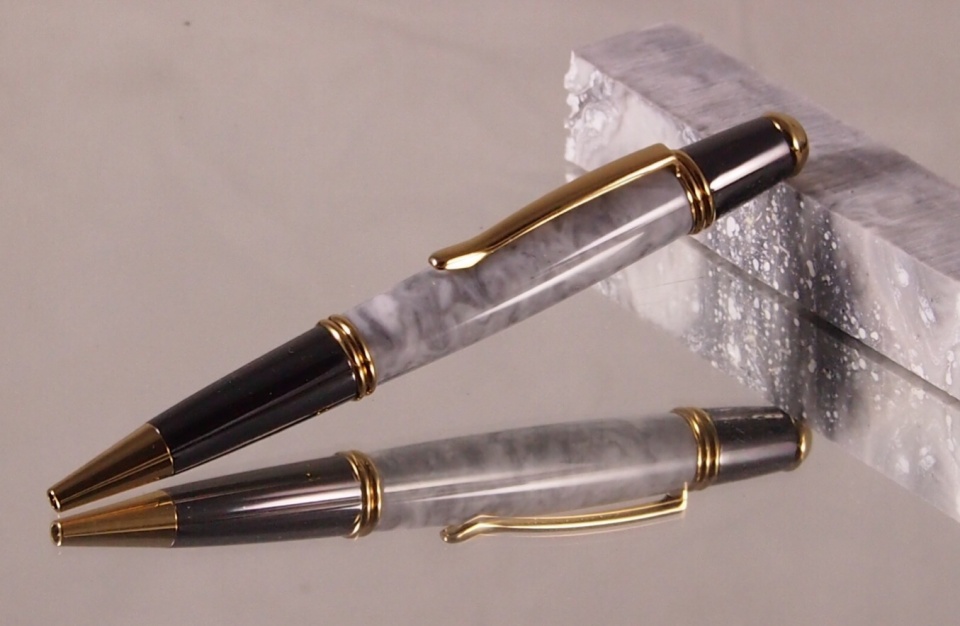

I made a second batch of harbor freight powder coat blanks. This one looks like marble to me. I used one of the blanks to dress of one of Smitty's Le Roi kits. I debated using a chrome and gun metal kit rather than this one. I think that I picked the right one.
