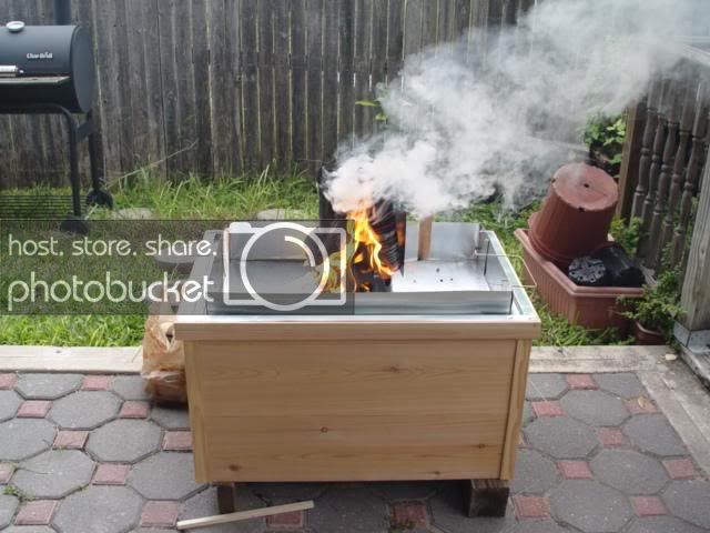

I have been wanting to make one of these for a while and finally took a break to make one. It is a "Cajun Microwave" and works by cooking the meat from above. You can use charcoal or left over scraps of wood (which I have plenty of). I made it from Cedar and the inside is lined with sheet metal. This is what I call the "Deployable version" since it only weighs about 25 pounds and can be easily transported. This is the first one I make and it was an experiment to see if it worked so I made it to look like a planter just in case it did not work I could use it as a palnter ;)

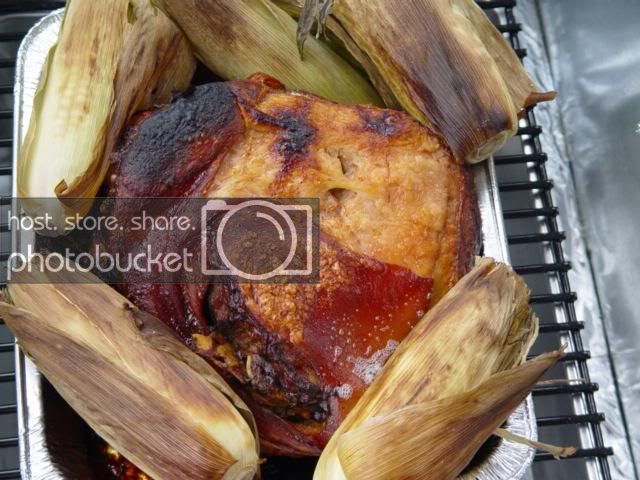

Here is experiment #1, it was a 12 pond pork shoulder and cooked in 4.5 hours:
Lighting the fire, it was a muggy day in Texas and the wood scraps created quite a bit of smoke:
This experiment used about 1/3 bag of charcoal and some wood scraps:

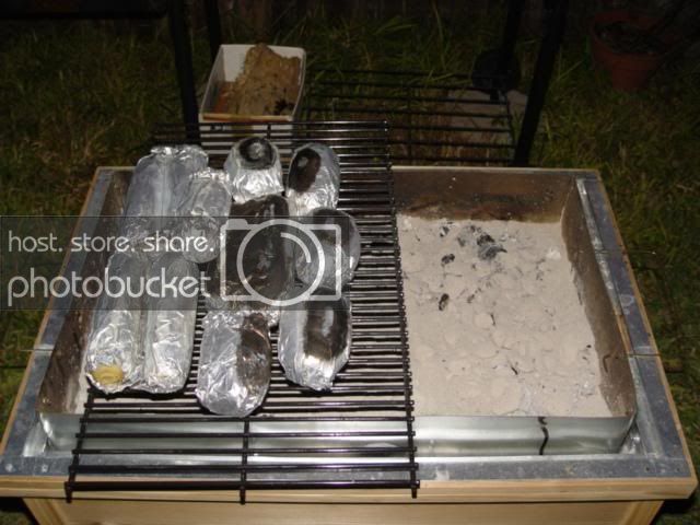

For the last 45 minutes I placed some corn inside to roast, here are the results:
And a close up:

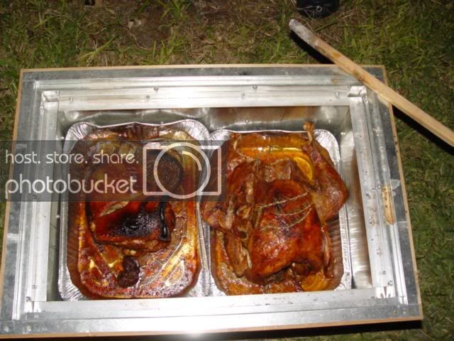

Here it experiment #2, it was a 14 pound shoulder and a 20 pound turkey, this one took about 6 hours and the weather outside was about 40 degrees. For the last 45 minutes I roasted some potatoes and corn with the residual heat from the embers:
And here are the results:

No plans for this one since I made it from pics I saw on line. But if it helps, the outer dimensions are 30" long by 21" wide and 17" deep. The bottom is adjustable so depending on what I am cooking I can lift the floor up wich make the inside cavity smaller so you have to heat up less area and it cooks faster. Also I forgot to mention, there is a layer of 1/4" "Hardi board" (it is a cement board that is used when making tiled counter tops) between the cedar and the sheet metal, it works as an insulator to keep more heat inside the box. This board added about 15 pounds to the overall weight.
