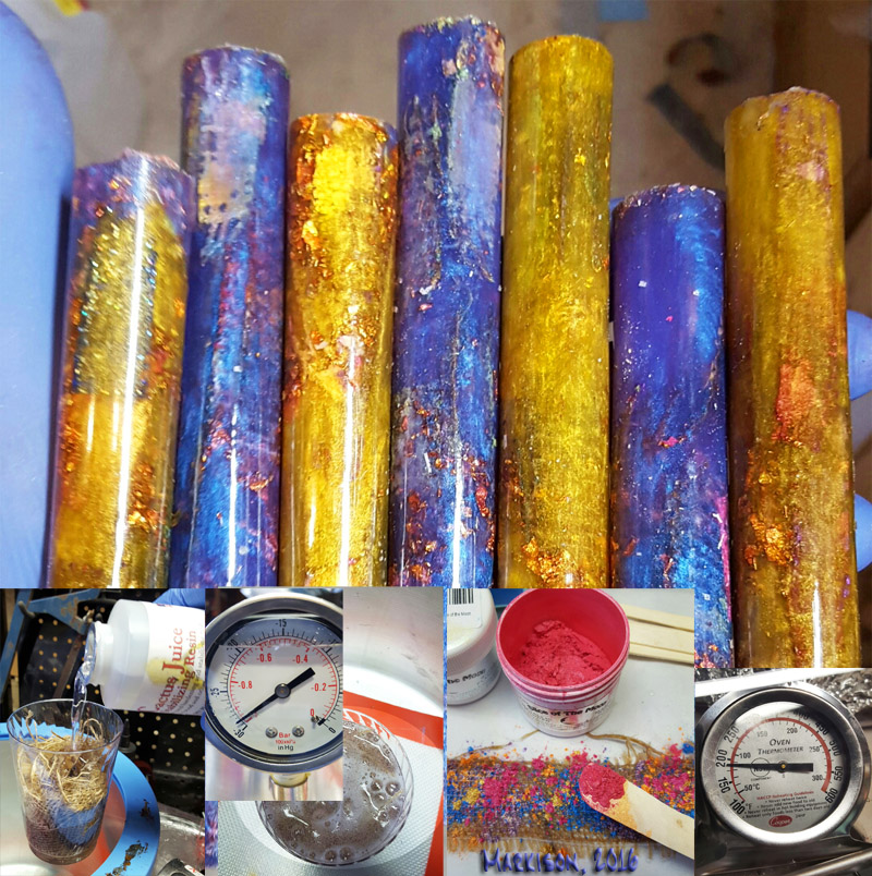

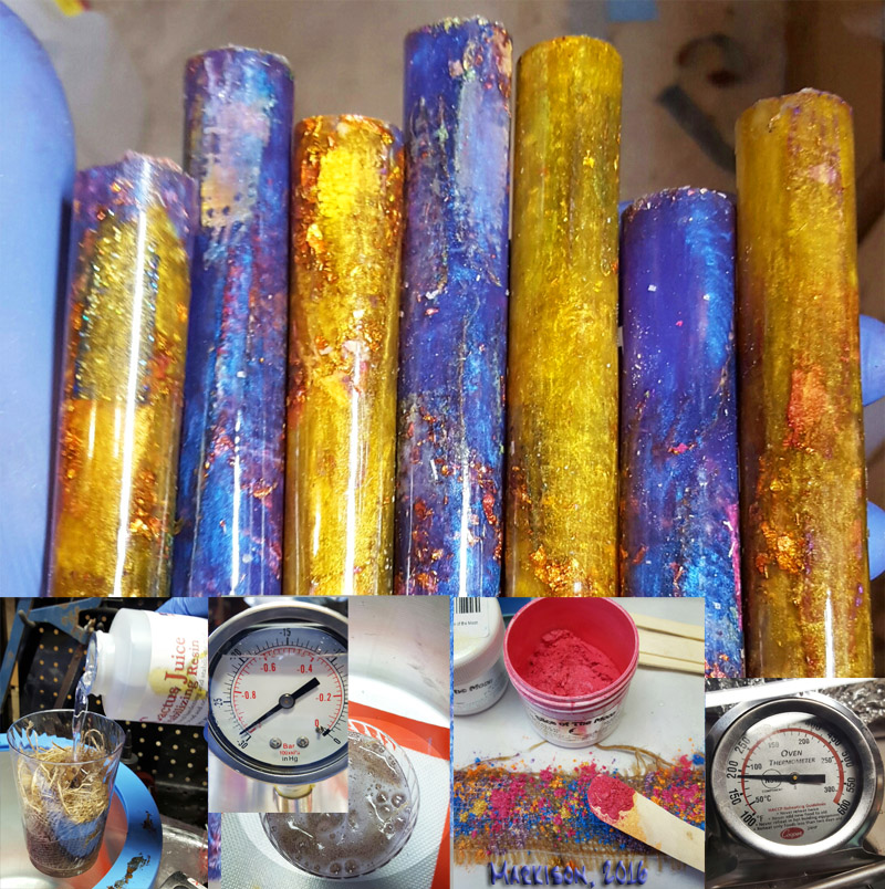

Wistfully recalling the iconic photo of Marilyn Monroe (then Norma Jean Baker) in an burlap Idaho potato sack, thought I'd stabilize some burlap in Cactus Juice, add color, etc. - ready for turning (stay tuned):

Hi Jose - Yes:
1) Cut strips of burlap
2) Place strips in plastic cup, and cover with Cactus Juice
3) Vacuum at -29"Hg until bubbling stops - about 5 min. for me
4) Drain, recycling CJ to its container
5) Sprinkle and rub pigment, including mica, onto/into burlap
6) Preheat toaster oven to 190-200 degrees (and I put ceramic 6" tiles on the floor of mine for even heat distribution)
7) Wrap the stabilized/colored strips in parchment paper - I use Kirkland brand - good pricing here:
Amazon.com: Kirkland Signature Non Stick Parchment Paper, 205 sqft: Kitchen & Dining
8) Place on tiled shelf of the toaster oven, cover parchment packet with a "dome" of aluminum foil to further diffuse the heat.
9) Cure in the toaster oven for 45 min.
10) Cut into smaller strips and fill your PVC pipes - I use clear 3/4" PVC (so I can see what I'm doing), with rubber stoppers - get clear PVC here:
FORMUFIT P034FGP-UV-5 Schedule 40 PVC Pipe, Furniture Grade, 5', 3/4" Size, Clear: Amazon.com: Industrial & Scientific
11) Pour in your resin - I used Douglas and Sturgess Clear Polyester Casting Resin - here:
Douglas and Sturgess: Clear Casting Resin, 1 Gallon
12) Pressure cast at 50 psi (I leave mine in overnight)
Hope this helps.
Hoping turn some pens over the next few days and will keep you posted.
Warm regards - Bob

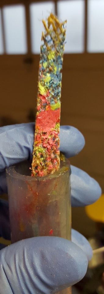

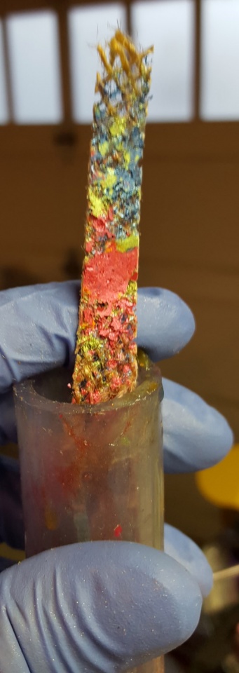

Dropping stabilized burlap strip into clear pvc pipe mold:
attachment.php

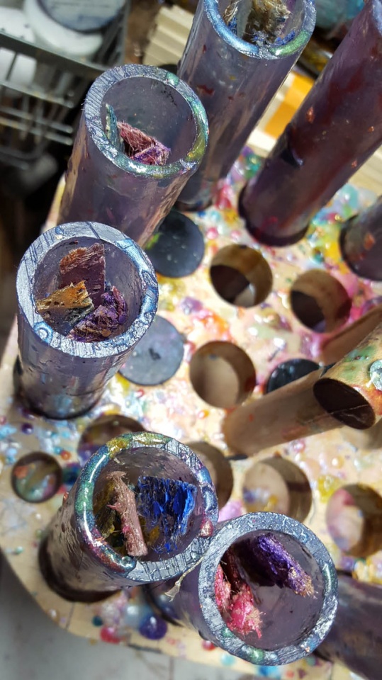

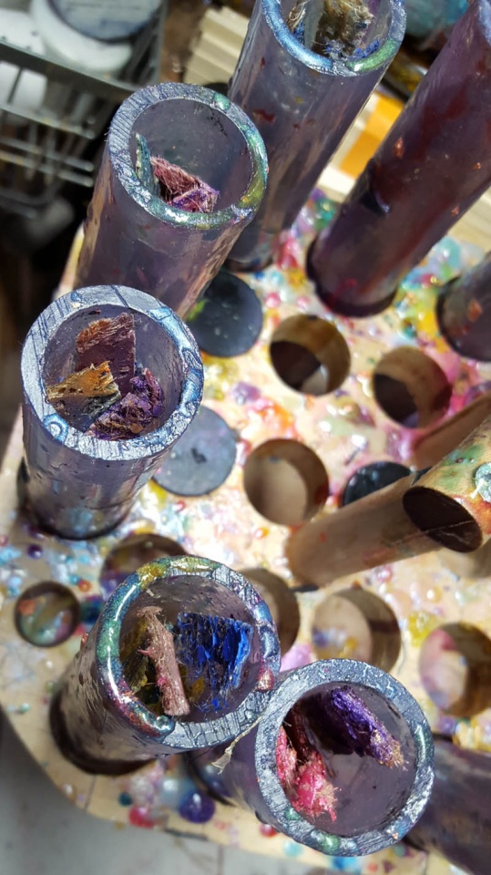

Burlap-stuffed pipe molds ready for resin pouring followed by pressure casting:
attachment.php
