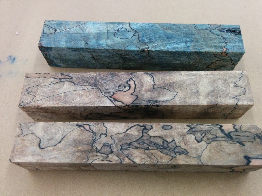

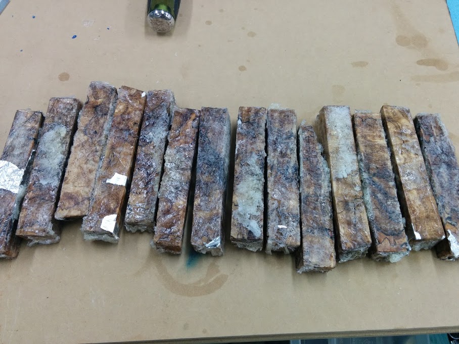

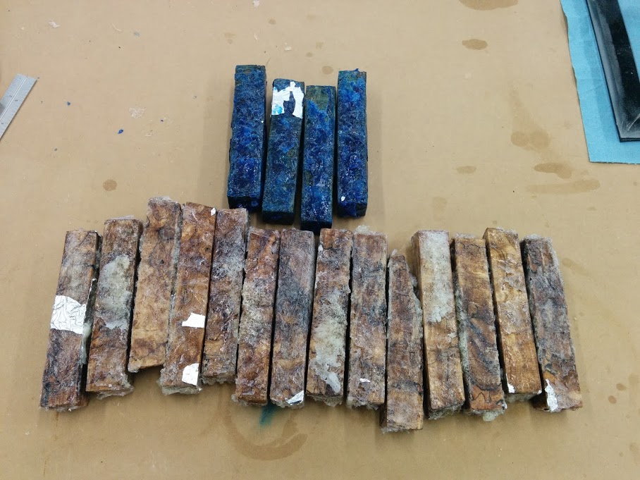

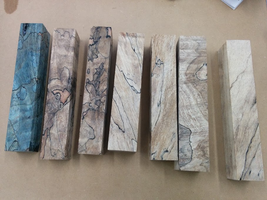

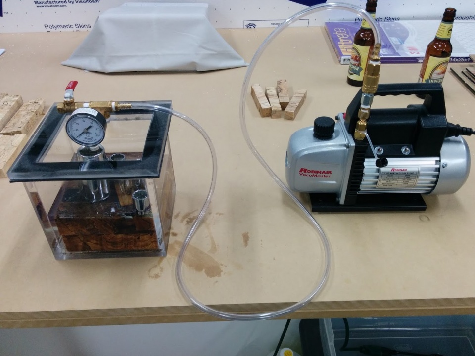

Well, here's a few of the blanks that I've stabilized. The first 2 pictures are of the blanks that I've cleaned up and the next two show the mess that the blanks are in after curing them. I wrapped them in foil so I think that the temp either got a little high or they weren't fully dried before the process. The last picture is the vacuum chamber that I made. Working pretty well so far.
I'll figure it out as I keep working with them but overall, I'm happy with them.
I still have many many many left to be stabilized, just need to figure out if the highly punky wood is worth using the expensive juice.

The blanks with the whitish areas of cured Juice on them is from moisture.
I figured, from all the info I've read. Other than losing juice, are there any issues that will occur because of a stabilized blank that wasn't 100% dry?

What material did you use for your vacuum pot and how thick is it? Also, what did you use for the lid seal? It looks really good.
It's 1/2" Clear Cast Acrylic that I got from Tap Plastics. The lid is starting to get some stress cracks in it, which doesn't seem like it will be a problem for a while, but will probably eventually put a 3/4" lid on it.
As for the seal, I'm not sure what it is exactly. It's some sort of 1/8" rubber seal that I had my brother grab for me from his work. We used it for sealing potable water pipe connections on tug boats. I'll ask and see if he knows what for sure, but it is a really nice seal. Just used some spray adhesive to glue it to the lid and it works great.
