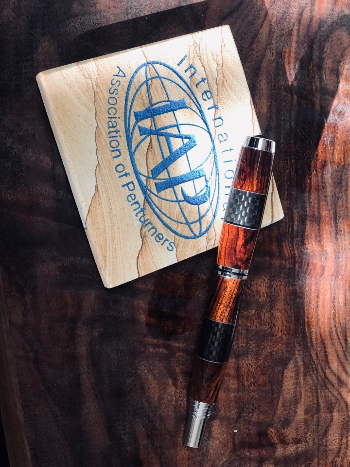

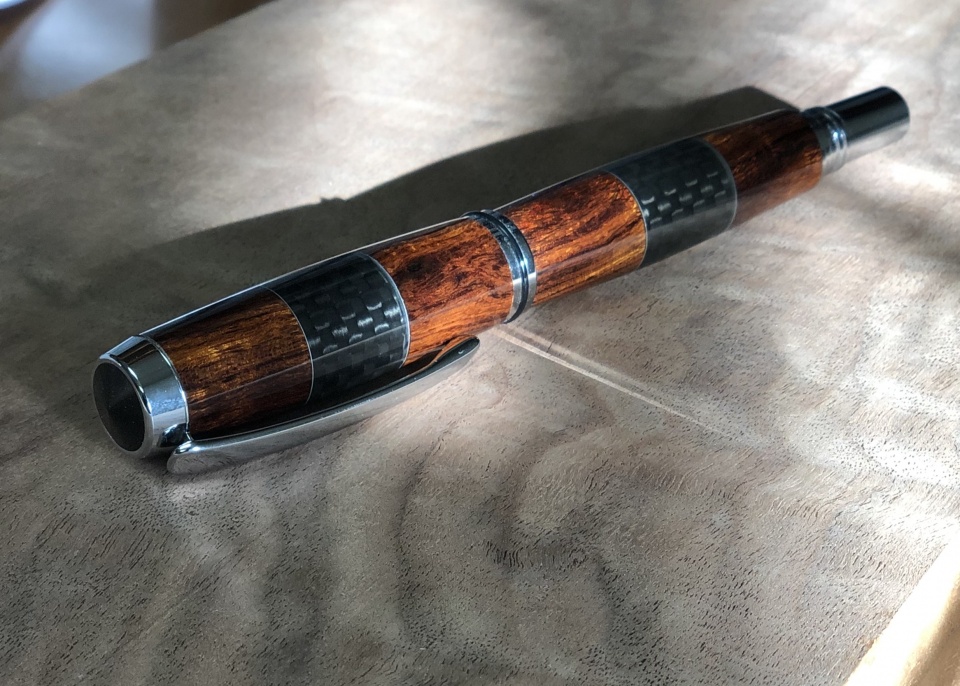

Something a little different this time. I used a pre-cast Carbon Fiber blank which I turned off the ends and added some wood and aluminum accent's between them.
It was actually quite difficult to take that carbon fiber off the tube. What I did was turn all the acrylic off first, then took a box cutter and just scored the CF and was able to take it off. I put it back on the lathe and used a square carbide tipped tool to make sure everything was nice and square.
