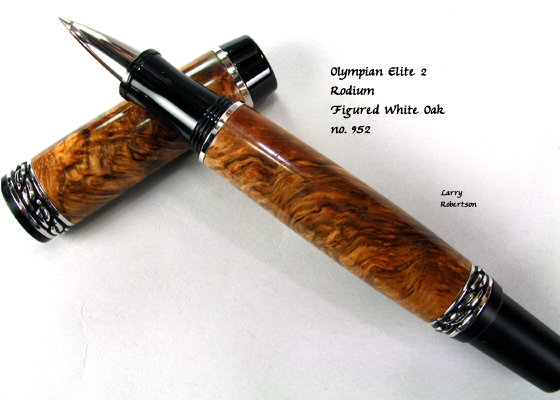

Hi Denny,
The pen in the attached photo is finished with Les's method. It works well on non oily woods. The poly will not cure on woods like rosewood. I've currently got a test rosewood pen in my curing locker, been there since March. The blanks are no longer sticky but they feel like the finish is soft; will probably sand it off.
But on Oak----
The method takes more curing time but the result is great. I sanded the one in the photo to 1000 grit and polished with Beall system.
