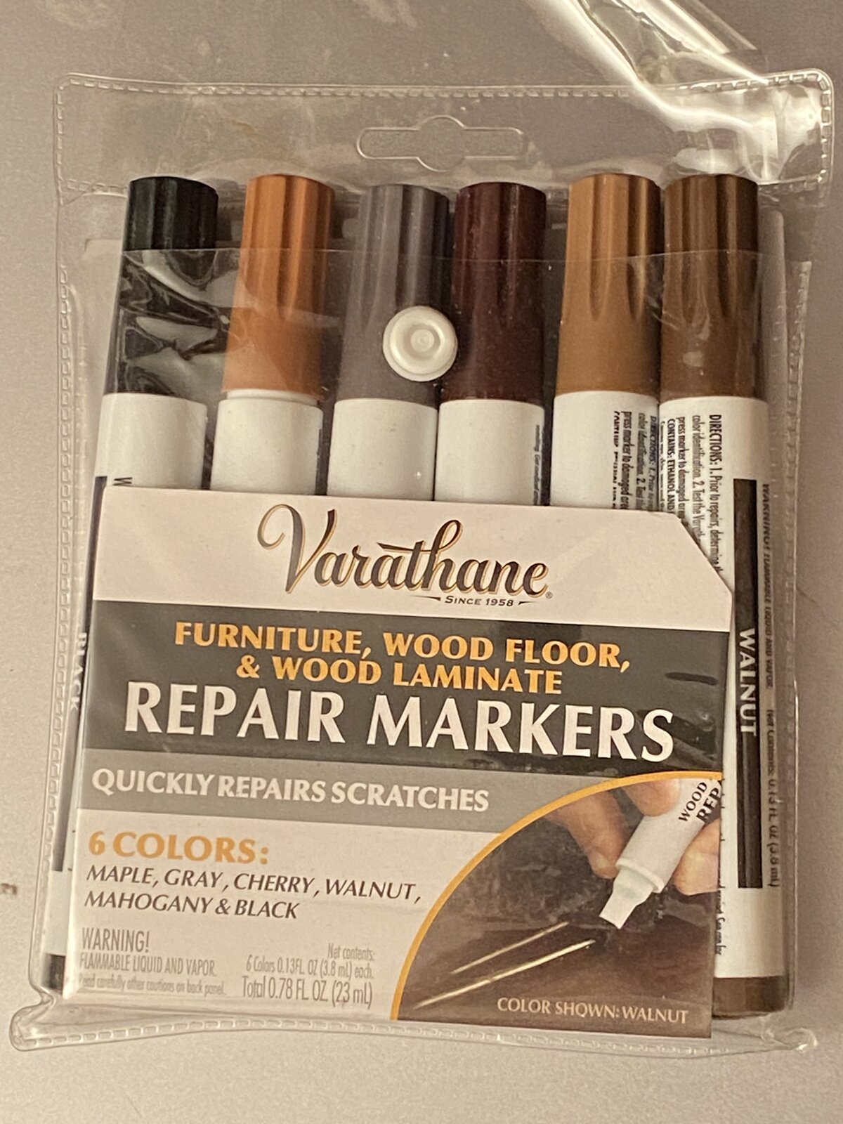

I have been turning pens for about 2 years and using CA as the final coat. I've noticed that if I use a spot touch up finishing pen to augment the color, the barrel will turn red when I apply the CA. Is there any way I can do this without having the CA interact with the finish imparted by the touch-up pen?

What is the "spot touch up finishing pen", that you referred to? Can you supply a picture of it. I ask because I've never heard of such a thing.
yes we need more info and or photos. have no idea what you are doing. What is the blank and why would CA turn something red? If it is interacting with CA then it is not compatible. Many paints are not compatible to be top coated with CA.
OK and Thanks. I do not have any examples because the pens were sold. The rich red color was very appealing and effected white oak, walnut, mahogany, olive wood cherry and others I can't remember. I just wanted to be able to shade in some areas and grain. With that said, the attachment picture is the culprit; Repair markers that I bought at the Home Depot. After sanding and smoothing the barrels I would shade the pen with a maple or cherry. I could understand the reaction of the CA if I didn't allow the color to dry, but even after a day of so, the CA would still turn the topcoat a reddish color. The CA I was using was "Stick Fast" Medium
Of late, I have been using BLO and then the CA, but I am real curious on how I can give the sanded barrels coat of the markers and not turn the wood red.

That is the problem. CA is generally used directly on wood or cast (generic) acrylic of different kinds in some cases, but not on top of repair markers. First time I have heard of this.
CA IS used on dyed wood, but long dried out. But dye is quite different than markers.
As Hank said that is a magic marker type color scratch hiding material and will react to CA. Even certain dyes will have a reaction to CA. Hey look how many times it comes up here when people do segmenting and then use CA and it muddies up the liter colored woods. Cross contamination is always possible. Samples and trials is the best way to avoid.
Yep, in this case the CA is acting as a "solvent" on the repair marker. Will do the same thing if a Sharpie or other type marking pen is used. As Hank noted...small scale experiments can help.
