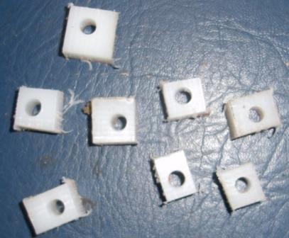

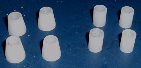

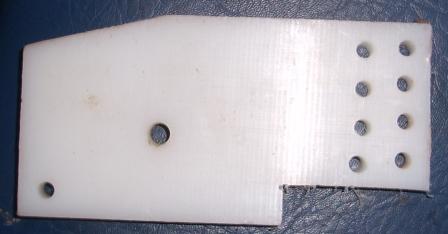

For final sanding and finishing I turn bushes out of a cutting board. Simply drill holes to suit your mandrel, cut out squares around the holes, then turn on the mandrel. Generally the cones are best, as they fit nearly all the kits :smile:
I do however still score the CA finish at the end of my blanks after coating them with the point of a small very sharp Skew, prior to final finishing, to ensure the CA breaks where you want it to. The CA then just peels of the bushes, although sometimes needs some convincing, as it tends to shrink on.
