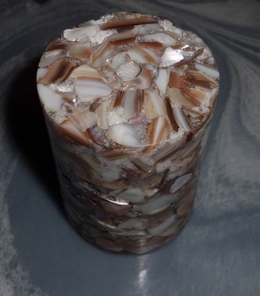

Skie_M
Aug 7, 2015
2,737
Lawton, Ok
attachment.php
Came out hard as a rock, with only a few bubbles that I can see round the outsides and near the top ....
There is a white haziness around the top 1/3 of the blank (it's the size of a bottle stopper or a bit larger) that looks VERY much like a coral growth ... part of this white looking cloudiness extends almost to the halfway point. It looks pretty cool! :)
I've drilled it all the way through with a 7mm bit, and I'm waiting pick up a 37/64 bit in something OTHER than a brad point, as that just plain sucks for drilling a hole in this stuff. It polishes up beautifully ...
Oh ... and this will be a tabletop perfume atomizer (PSI kit).
So ... while it refused to harden right away, it did eventually harden after a while. (I left it sitting on a mirrored tray in the bathroom for a week, to let more moisture get to it.)
