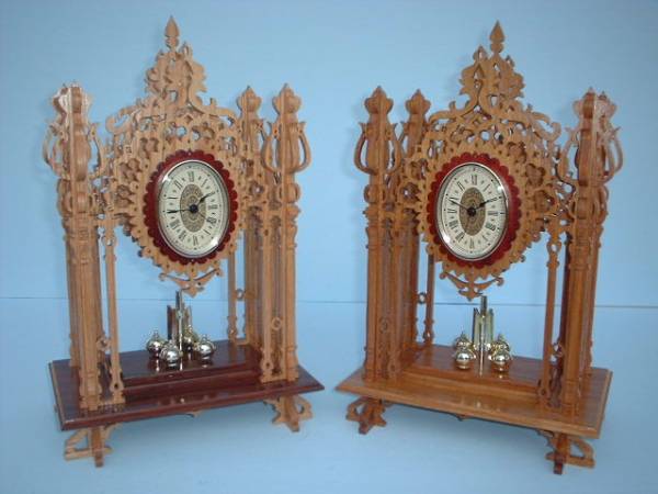

I am a huge Watco Danish oil user as a finish for my scrollsaw work. Just wanted to show an example of the color and the shine I can get with it. Clock on the left is red oak and rosewood base. The clock on the right is all canary wood. The clock trim rings are padauck wood. All take the oil well and when buffed abit they can take a nice warm glow. The thing to remember with Danish oil it is boiled linseed oil and dryers and mineral sprits with also some polyurethane in it. It pops any wood with a nice warm touch. I use to go through gallons of that stuff. Talk about price increases, man.
