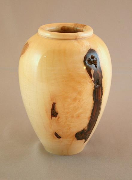

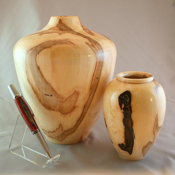

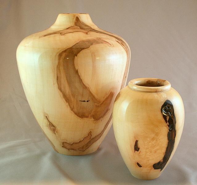

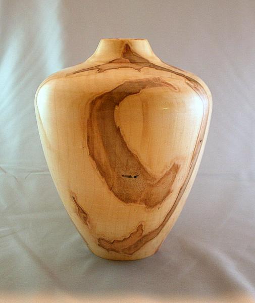

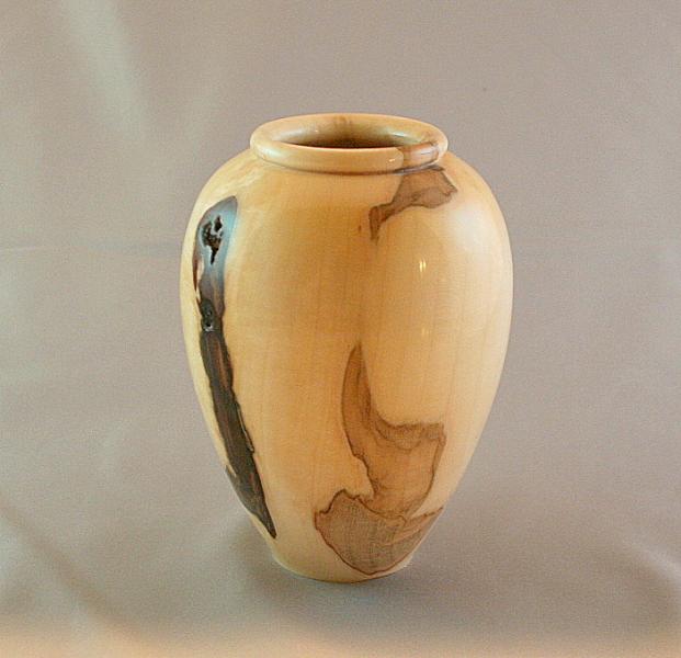

I have been working on a couple of larger projects of late. Here are a pair of ambrosia maple hollow forms that I finished last week. They both have a CA glue finish and the smaller one is real slick. Comments are welcome. Russell

Very nice, the whole thing, finish, form, wood every thing. I tried C/A on larger forms but it just didn`t work for me. It dried to fast, i did not try hard to work it out, just dismissed it. I think i will try again. Carl
bradh
Mar 9, 2005
688
Aurora, Ontario, Canada.
Very nice work. The finish looks great too.
I too have tried CA on larger items and found it difficult to get a smooth finish. What type of CA are you using?
Russell Eaton
Sep 9, 2009
788
Stockbridge GA.
Stickfast CA. They have a formula JUST for finishing. It has been on the market for less than a year. I think Roy sells it as well as several other vendors.
leehljp
Member Liaison
Feb 6, 2005
9,347
Tunica, Mississippi,
Great looking work! The finish appears to have more of a sheen finish instead of the deep shine of a 12000 mm finish. Was this intentional? Or is it the photo setup? I have done a few pens and a bowl with CA with the sheen/no shine finish.
I did a coffee mug with CA and it was hard for a consistent finish (it was shiny), the bowl wasn't. But all of that was a good while ago.
Russell Eaton
Sep 9, 2009
788
Stockbridge GA.
Lee the reason for the "sheen" is it needs to be buffed. I wanted to let the glue dry fully before I buffed it out. I may even use wax on it as well. The photo does make it look more satin than it is. Thanks for the comment.
leehljp
Member Liaison
Feb 6, 2005
9,347
Thanks for the reply. I am always interested in what other people are doing and I haven't seen very many posts with CA finishing on anything other than pens. Thanks for sharing this. I do plan on using CA as a finish for small bowls again in the future.
