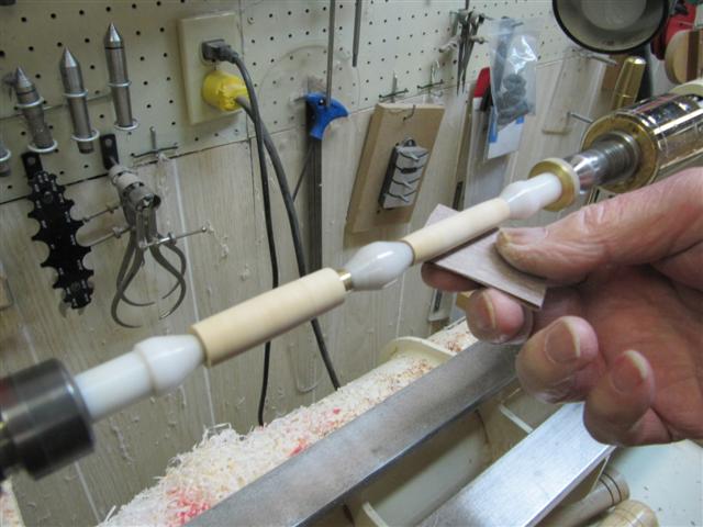

Another method is by using johnnycnc's Eliminator 805 bushings.
http://penturnersproducts.com/index.php?main_page=index&cPath=2_15
Here's a pic of them in action!
attachment.php
JohnnyCNC is out of town for a few days, but his Eliminator Finish Bushings (shown in Mack's photo) are one of the best purchases I have made.
Haven't had a problem gluing the blank to the bushings, but I've glued the bushings to the mandrel! I finally clamped the bushing in a vise grip and dropped the end of the mandrel into a vise that was slightly open, so the rod was loose but the bushing with the visegrip was resting on the top of the vise, and drove the mandrel out with a hammer...sort of like disassembling a pen.
I wax mine with carnauba wax and have very little problem with the CA sticking. The CA lip gets a light sanding with the first micromesh pad to clean it up.
Otherwise the wooden cones Rick show work well, I made a set from ebony for turning kits I have no bushings for.
These Eliminator Bushings are highly recommended.:wink:
