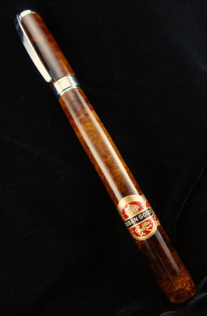

I finally shot a photo of the closed end cigar pen I'd talked about in my postings above. The wood is silver maple burl from a tree that a friend of mine had taken down a few years ago. After turning, I dyed the wood to accentuate the depth of the burl and to replicate the color of tobacco leaves.

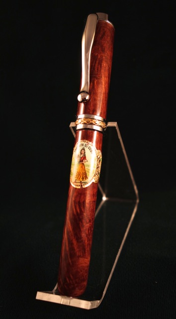

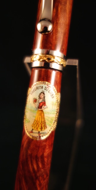

I had a redwood burl pen blank with an interesting pattern that I thought was well suited for a cigar pen and I just received some beautiful vintage Cuban cigar bands, so today I turned another closed end cigar pen. For this one I used the Triton kit and a CA glue finish.
