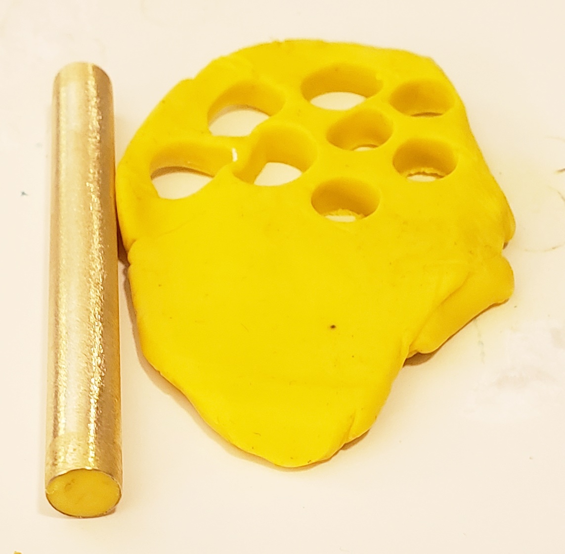

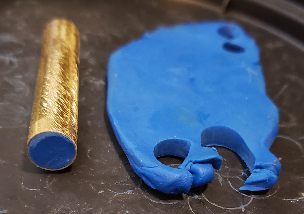

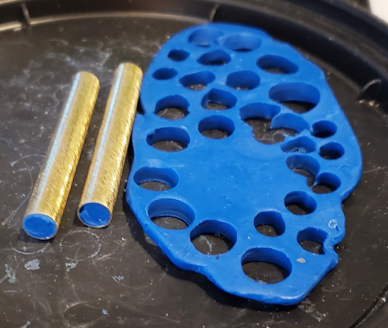

As for trimming the ends, you have to have the tube(s) glued in and and the glue set before you can trim, whether you use a trimmer or sanding disk. One little tip I learned here years ago is to put something in the ends of the tubes before you insert them, like modeling clay or even a slice of potato. This keeps the inside of the tube(s) clear of whatever adhesive you're using. I drill them out before trimming.

.... One little tip I learned here years ago is to put something in the ends of the tubes before you insert them, like modeling clay or even a slice of potato. This keeps the inside of the tube(s) clear of whatever adhesive you're using. I drill them out before trimming.

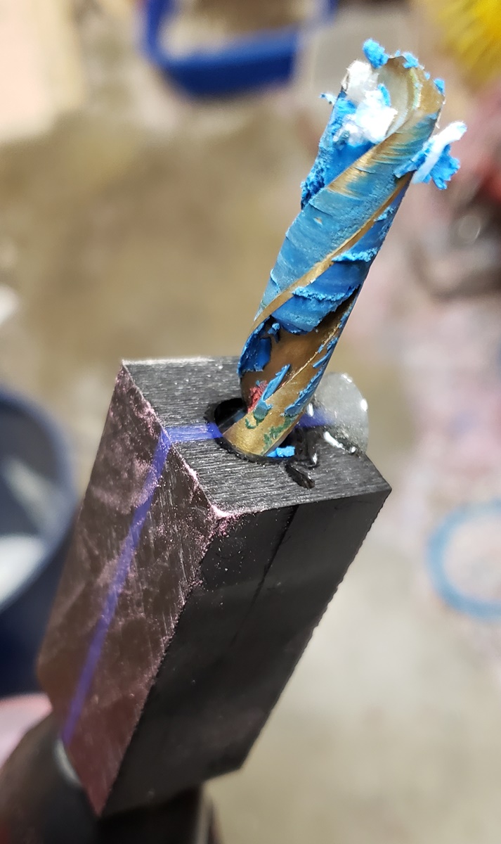

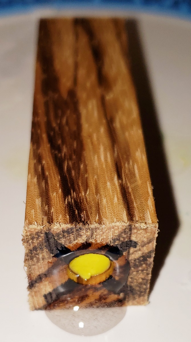

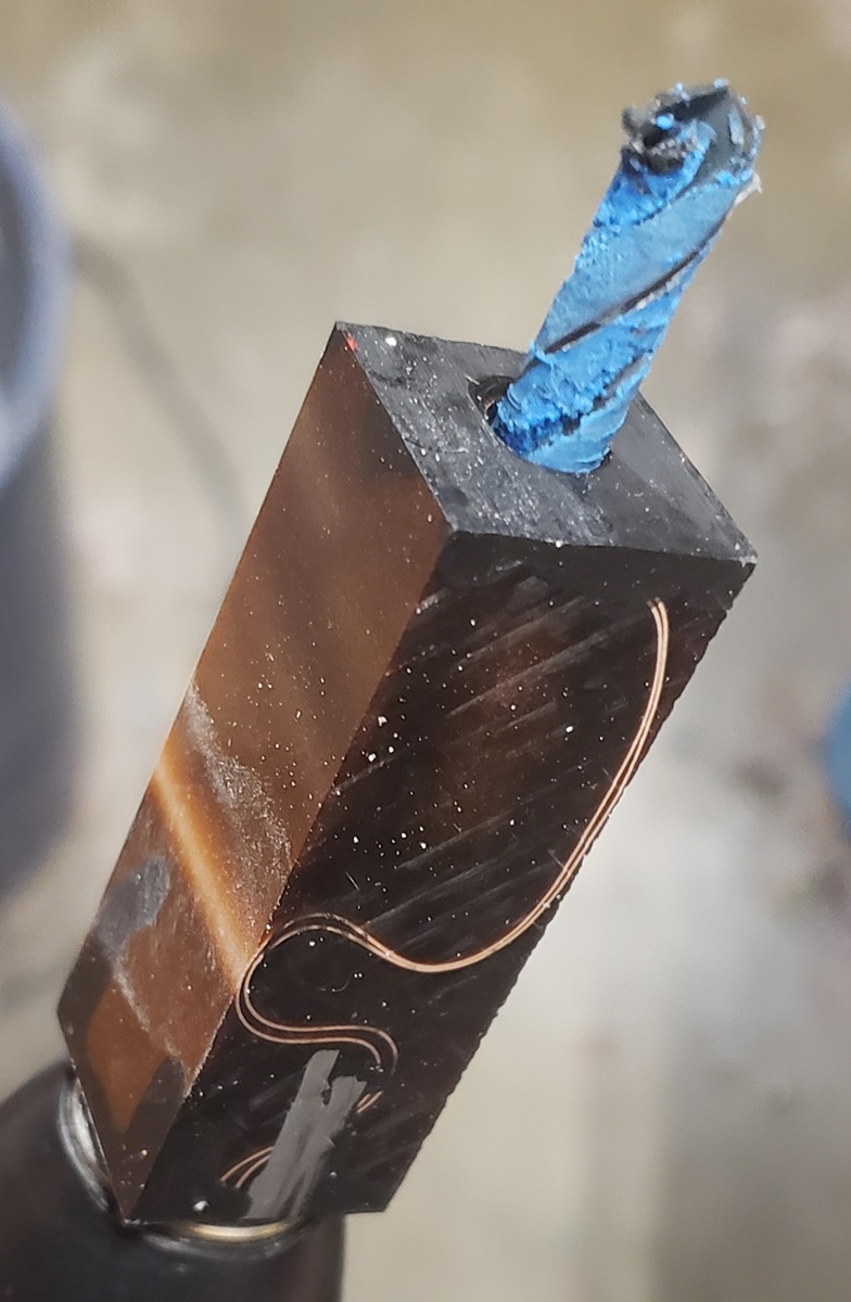

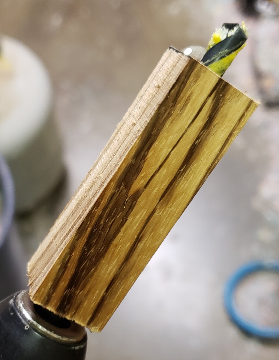

I used to do that, but have found that modeling clay works better. Then I use an appropriate size drill bit to clear the clay and dried epoxy.
