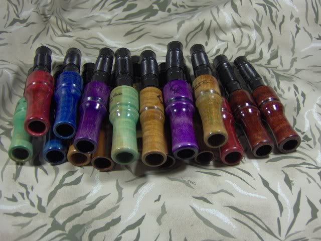

I will answer the dye question. Maple can be dyed with just about any type of dye, I prefer Fiebings Leather dye, it comes in all colors and if you mix colors the colors are unlimited. The pic is an example.
