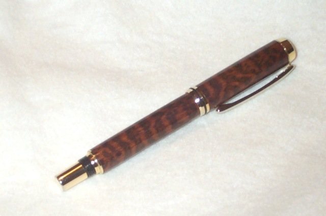

I turned a snakewood sierra and was going to apply a CA finish combining some points in the article by Fangar and the one by Gregory Wilson. I applied two coats of medium CA sanding to 12000 each time. I did not have the glass like finish yet, so I purchased some thin CA, DNA and some accelerator. I cleaned with DNA and applied a coat of thin CA. I then sprayed from about a foot away with accelerator. When I started sanding, I noticed a full length crack from end to end. Due to what I have heard about snakewood, I had only minimal pressure on the knurled knob on the mandrel. I applied the CA turning at 500RPM. Two coats were fine, just not shiny enough. Any suggestions? Thank you for your comments. I have the other piece of the blank to do but I am hesitant. - Chris

The CA curing process causes a lot of heat. Especially when you use accelerator. No where in my method do I mention using accelerator (Unless you count me saying not to use it [:D]), so that must have been from somewhere else. Snakewood is very elusive. I have turned pens that have not cracked, and am currently working on a technique that will likely fail as well. But who knows... It might not. I would likely have another go at it and attempt to not use the acclerator, and whatch the heat like you mentioned. I would also try using compressed air to clean the blank as opposed to DNA. The alcohol might have caused issue as well.

I sure hate for you to be taunted...that 15 yards in the NFL.Send it on to me and we'll wave off the flag.[:D] Seriously, I've decided that even a cracked snakwood pen is nicer than most anything else. So, I've been turning them to almost finished and set them on a shelf and let the suckers crack. Place them back on the lathe, use CA and sanding dust to make a slurry and repair the cracks. Finish turning and apply my normal CA finish. The cracks are almost invisible and the pens are beuatiful. Even Omas' snakewood pens crack.
