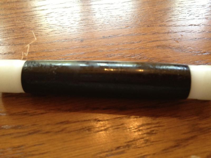

I've got a Kallenshaan blank (blackwood with holly inserts) that is absolutely gorgeous. It turned quite nicely, but now that I'm trying to give it a CA finish I'm having all sorts of trouble. I get spots where, after sanding, there's just no finish at all. These might be high spots, because I can't sand this kit (due to possible contamination of the holly with blackwood dust) but I'm not convinced.
Lately a number of my attempts to use CA have been ... frustrating. The cure is really slow when using BLO & medium CA (Stickfast brand, from Woodcraft). The finish gets rougher as I add layers and I invariably have to use a skew or my Woodchuck Pen Pro to knock it down before sanding.
It's enough to make me swear off wood pens altogether!
Any ideas for how to finish this project? It's for my sister, so I really want to get it right....

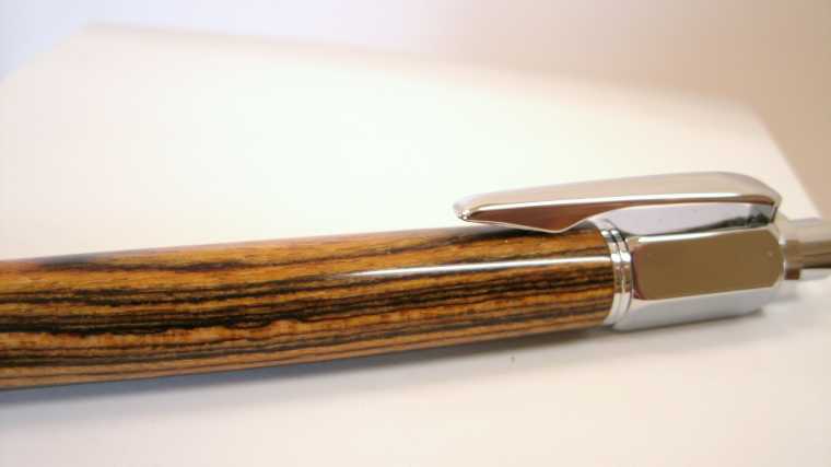

It's a lot of work, but I am actually getting happy with the results (see sample pic below)
attachment.php

African Blackwood is loaded with oils and needs to be cleaned of oil before finishing. The spots are where the CA did not stick due to oil in the wood. I use accetone, others use DNA to clean the oil from the blanks.
I would use accetone to strip the CA off, let dry, lightly sand from 2400MM up and then try the finish again. You should see a big improvement when the oil is gone from the wood.

I did use DNA (I always use DNA before any finish application to remove sanding dust) but will try acetone after stripping it down again.

Not yet a year old, but who knows how long it sat on the shelf before I got it. I'm picking up a fresh bottle today and we'll see if that changes anything. I'm also going to ditch the BLO for a while and see if just using accelerator will work for me without the ghosting I got on that one cap.
