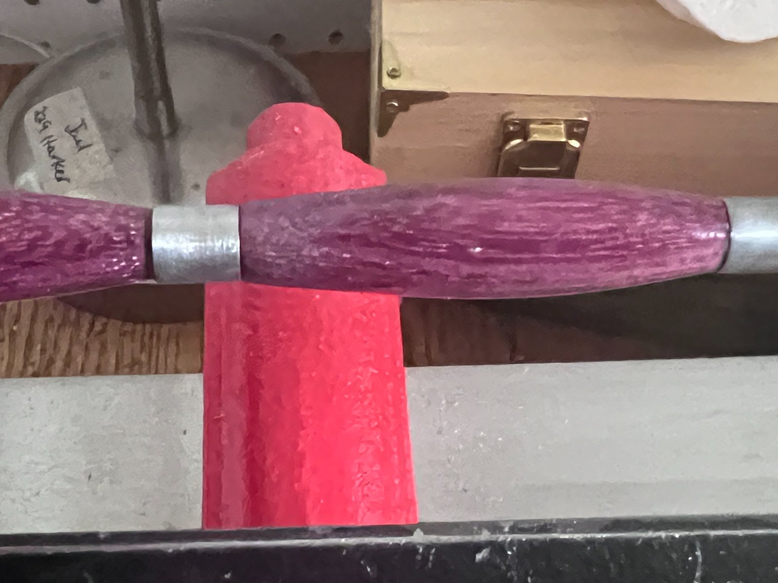

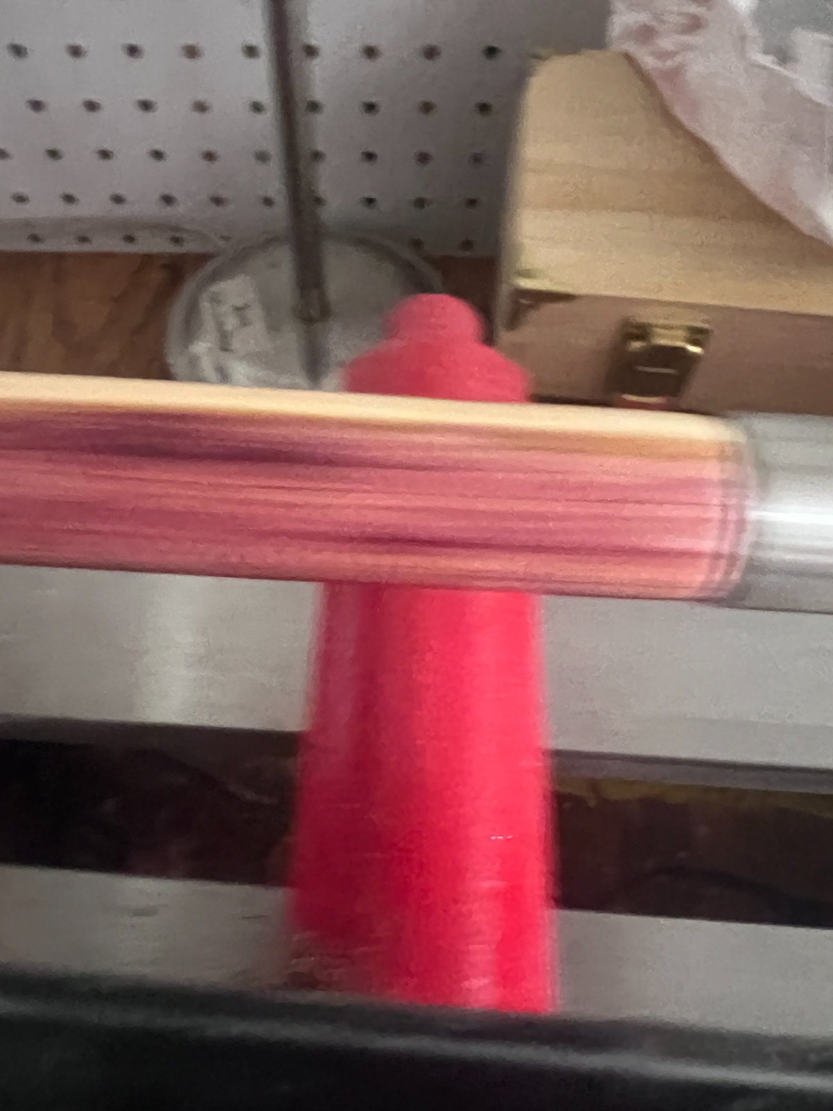

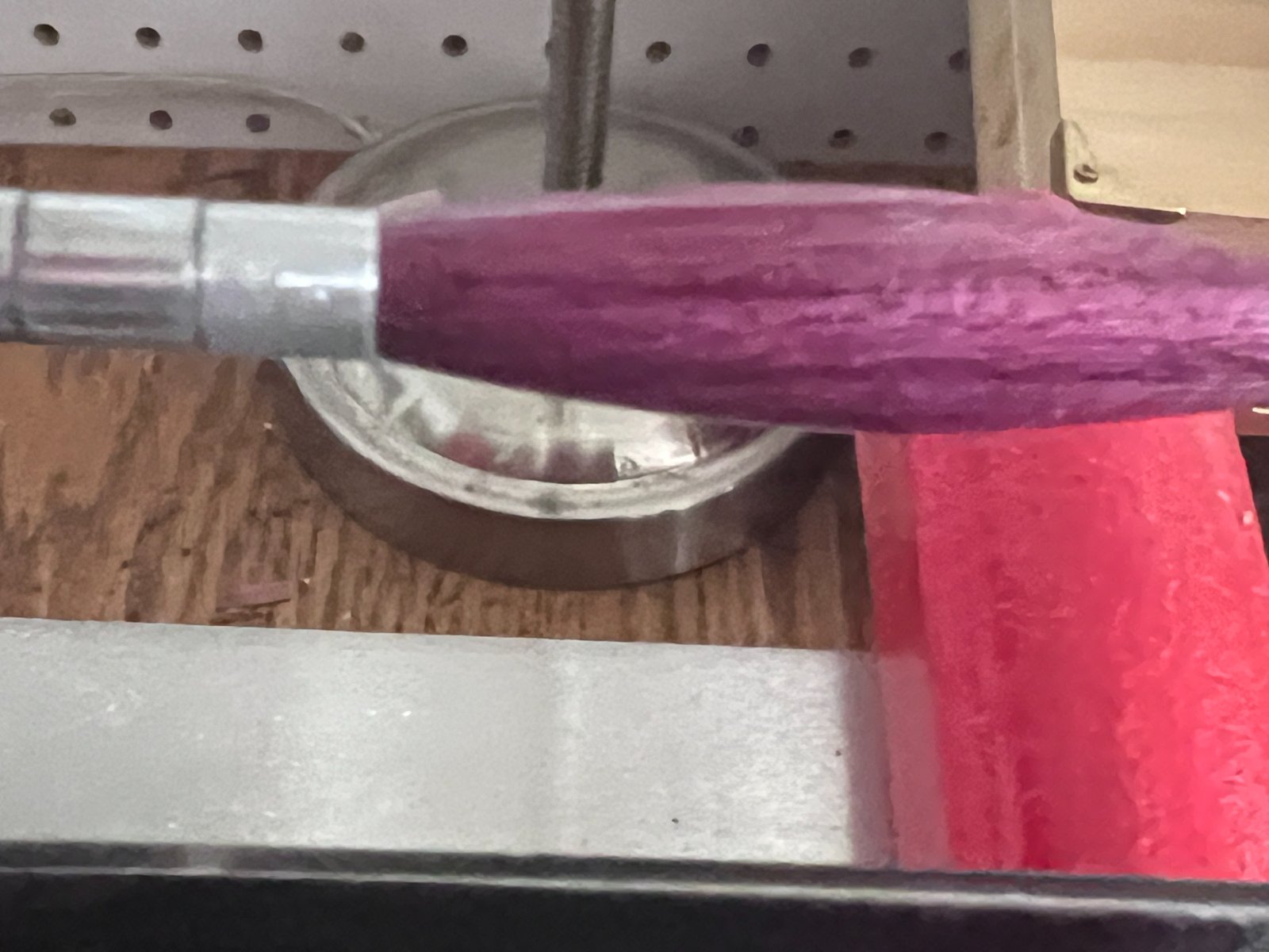

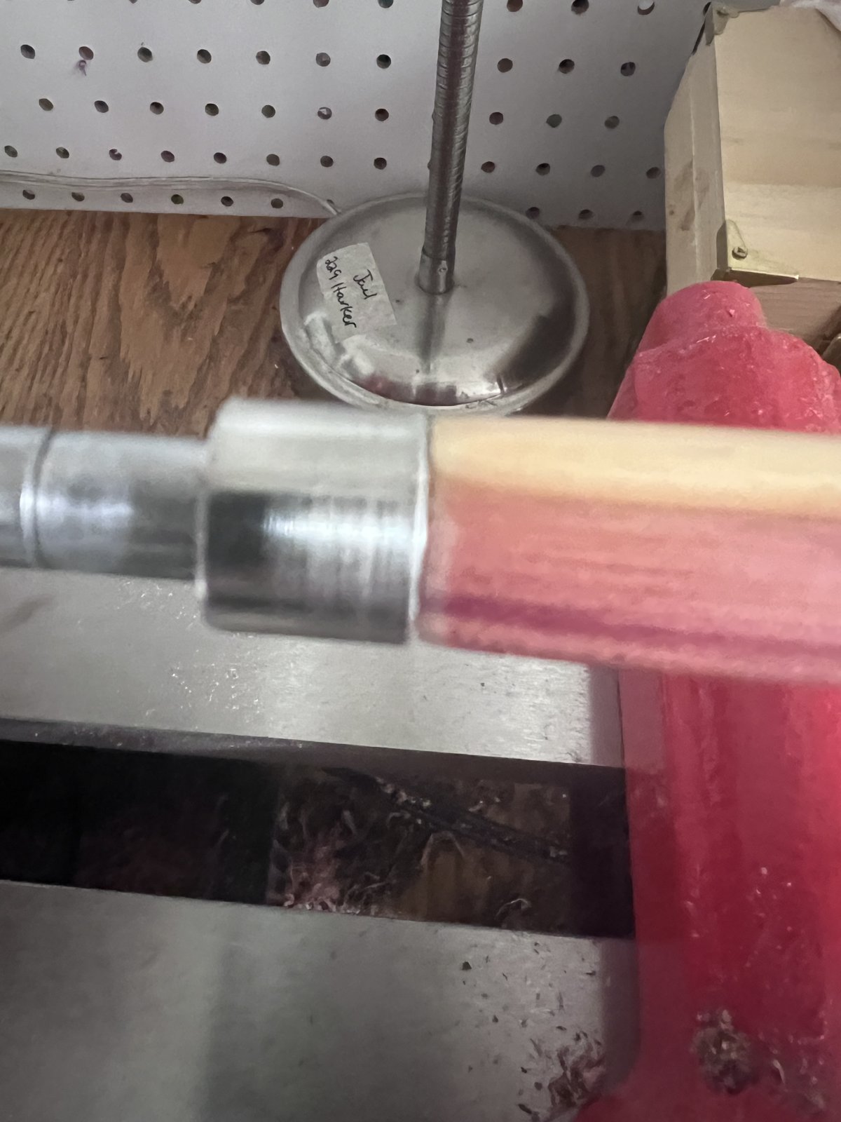

I have been finishing my pens with CA glue. Recently, I've started noticed a "discoloring" after I finish wet sanding and polishing. It looks like the wood got wet from wet sanding. In the thumbnails, the cedar blanks, the discoloring is on the ends. However with a purple heart blank, I noticed discoloring in the middle and the ends, but it is more of a gray hue.
I don't the see "discoloring" when I initially apply CA glue but only after I wet sand the blanks. which makes me think I'm doing something different/"wrong" with wet sanding. I sand the blank with 600 grit, then apply 6 layers of thin CA glue, spraying with an activator after each coat. Then I switch to wet sanding. Start with 600 grit wet sand paper with a light touch. Then 400, 600, 1,000, 2,000, and 3,000 wet sanding sponge. I started soaking the sponges in a bowl of water before using. Maybe the sponges are too wet?

Try to seal your ends with a little CA before you sand. This will help prevent the edges from pulling away from the wood, which allows sanding grit to enter under your CA from wet sanding. At least this is what I think happened.

Jeff you are running into situations that we all have at one time or other. The responses to seal the ends is a correct one. You want to do this before wet sanding because water can wick up under the CA and cause the cracking of the CA on the ends. When sading try not to round over those ends because you will sand away the protection. If this happens just dab a little more on there.
As far as the purple heart goes. It looks like not enough layers of CA were applied and you may have sanded through it. Also with Purple heart it will have a tendency to be a dull color when first turrned and sanded. Then over time with UV light it will start to turn more deeper purple. So to me it looks like a sand through.

Sealing the ends is what fixed it for me. I simply fold up a piece of paper towel to use as a blotter, drip a few drops of thin CA on it, then push the pen blank down onto it and twist it back and forth a couple of times, let it dry a little while and then repeat a couple of times.
I started doing this because I was occasionally having adhesion problems with my CA finish on the ends. I would get a separation that looked like the gray-ish spot that is clearly visible in your first picture. It was caused by air between the finish and the blank. Sealing the ends seems to have fixed the problem for me so it just became part of my standard CA and GluBoost regimen. - Dave

I wet sand CA finished wood all the time and I agree with previous responders that this looks like:
  1. The ends weren't sealed with CA.
  2. You sanded through the CA in some spots.
