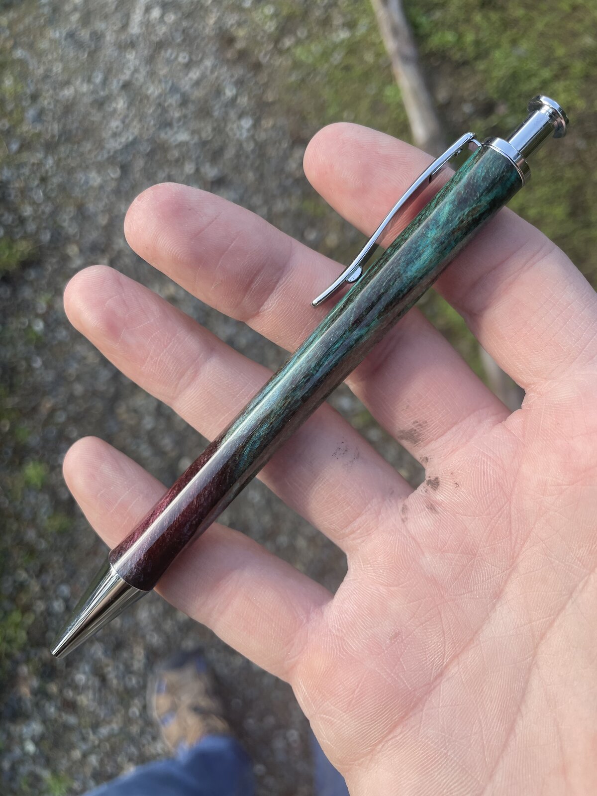

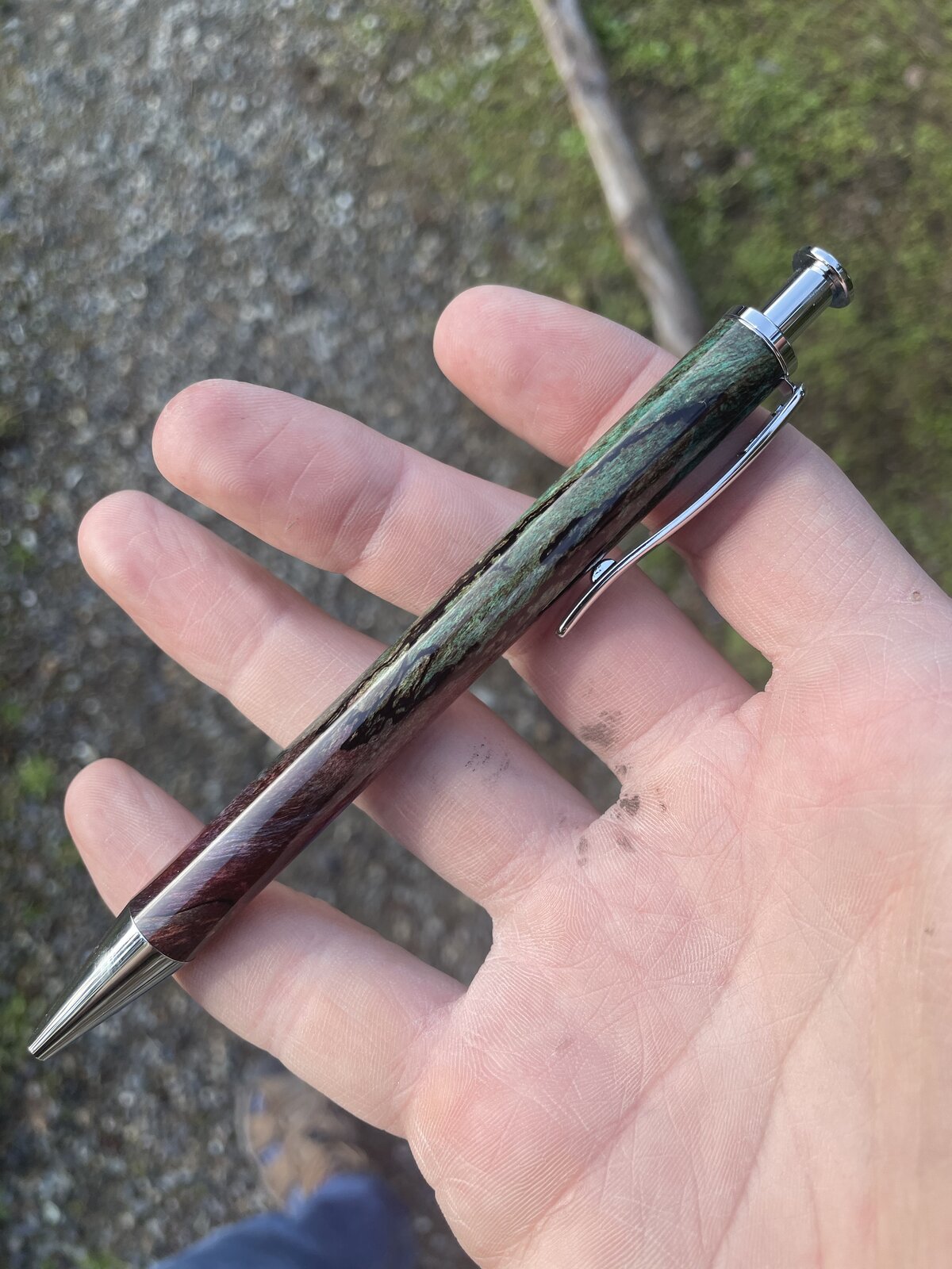

Well, I made a quick video detailing how I do a quick and simple CA finish from 600 grit on the raw wood to final polish. I misspoke multiple times including when stating my own age (I'm 29, not 28) 😂
I hope this helps somebody who's struggling.
Cheers
Here is a couple photos of the finished pen:
