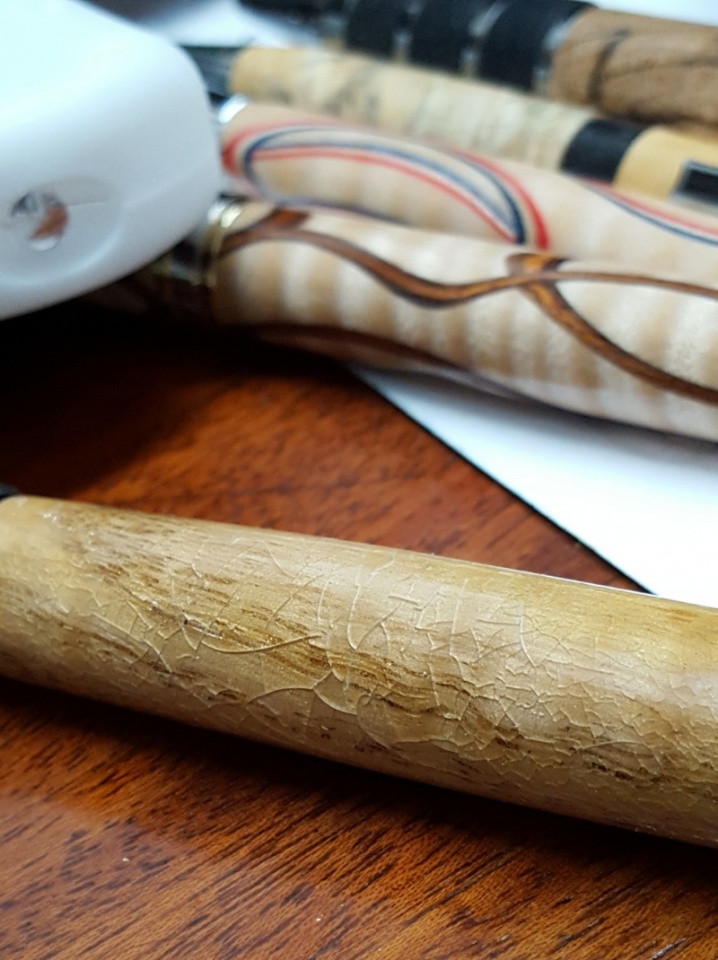

Your CA is too old. I do not keep CA longer than 6 months. Here is why. Unfortunately I have about 30 pens that need to be stripped and refinished.
Stop using activator.
Having the same issue lately and I have had my same CA bottles awhile since I took a little break from making pens. I used activator before and never had cracking though.
