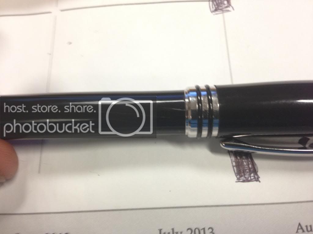

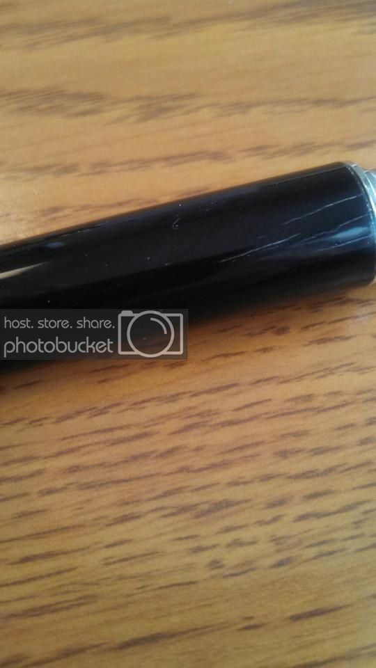

I'm obsessed with Ebony and how it looks with a 10 layer CA finish. I've turned several of these pens in different kits and use one daily. The one I use daily is great; it's a Majestic Junior- fountain nib. Been using it for about 3 months. I had a couple of friends from out of town notice my pen and ask if i had any extras. I just so happen to have a Majestic and a Tycoon in ebony on hand and sold them to them.
Some additional background: I live in South Georgia where it is hot and moist all year. Humidity never falls below 70% it seems. However, my buddies live up North, one lives in Connecticut, and the other in Iowa. Quite the extreme compared to Georgia. After about a month I received a message from one of them saying they noticed small cracks all over their pen. I asked the other guy and he said he noticed the same thing.
Kind of rough considering they paid a decent penny for those beauties. I did research all over to try to figure out why this would happen. I couldn't find any exact posts here or there stating why this could happen. The pen i use still looks brand new, no cracks. My CA finish has never had a problem, except these two cases... I've done over 400 pens in CA finish... WHAT GIVES?
Then i remember i had a Gibson Hummingbird guitar purchased in Michigan and when I moved it to El Paso... it pretty much DIED. I wonder if this could be the same situation with the pens. Since they are cracking around where they join the metal hardware, could it be that the wood contracted because of the dry cold weather, but the CA finish did NOT contract with it so it cracked? Anyone else notice or have these problems?
I'm going ahead and making them new pens but using M3 Volcanic Ash to make up for it. I don't think those will crack.

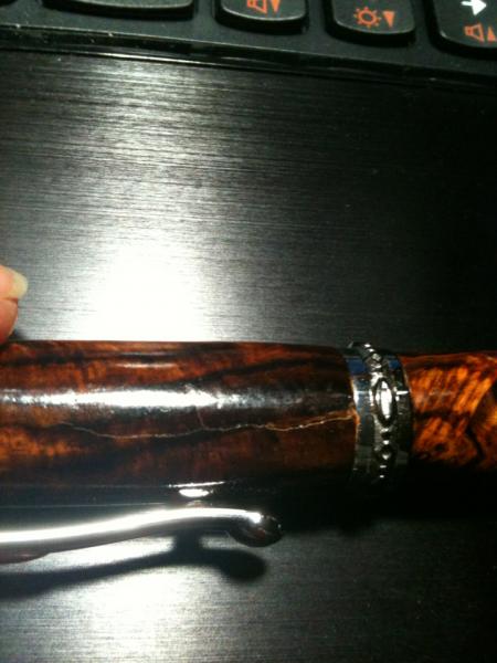

I'll put it this way.
I made this Cocobolo Burl Pen about a year ago. Been in my case for well over a year with no issues. Sent it to my Sister in Law in November/December.
This is what she received,

Ouuuch. That's rough Ruuskiwolf
I'll take all recommendations and put them to the test. i'll change to Blackwood (you can get away with calling it Ebony too ;) i'll see if my guild can get them as cheap as we get Ebony @ $0.80 7/8 x 7/8 x 6). I'll finish it out and then let them set for a week inside my house where it is climate controlled instead of the no controlled shop... then ca finish them.
