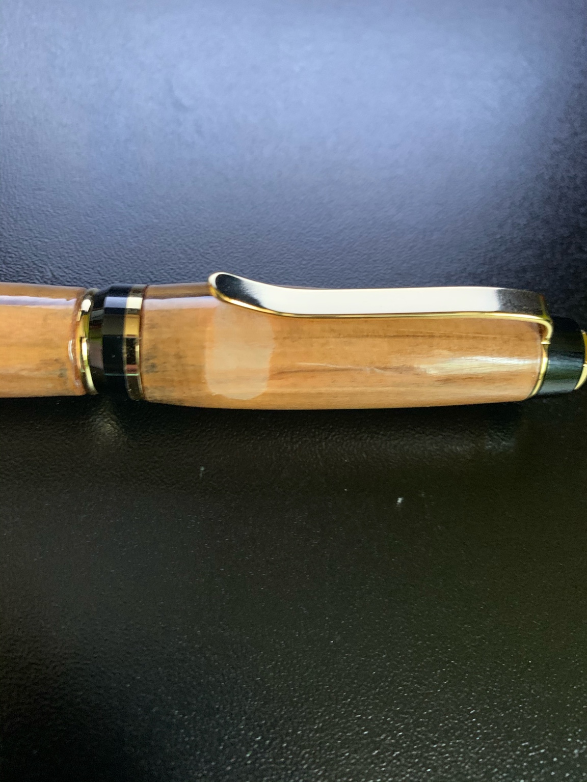

I have had this problem on one other pen recently while applying a CA finish. Any ideas what my problem is?
xCykax
Jul 4, 2020
20
Boise, ID
Jack,that sounds almost like you've sanded through the CA finish. If it was just cloudy CA you wouldn't feel any difference.
Sent from my SM-G955U using Tapatalk
That may be possible. I applied two more layers after I had noticed that spot and it still remained however.

sanded through. The wood appearance will change in the area that you sanded through even if you just reapply CA - different amount of contaminants/oils, penetration of CA, sanding grit, there are a zillion factors. Some woods/materials it's not noticeable when you reapply, others you can't not see it. One option is to turn away all of the CA and start over on the finish.
Dehn0045
Mar 19, 2017
1,327
Houston, Texas
Also, this is one topic that comes up about once a week, so you're not alone. There are some pretty lengthy threads about various factors - search "sanded through CA" in the search bar if you want to dig a little deeper. Not trying to discourage asking questions, just that sometimes you get less details when a topic has been recently covered

If you applied more CA then that light spot should have blended right in. Secondly, that looks like a patch. If you were sanding on a spinning lathe that spot would go all the way around the blank. You'd be hard-pressed to sand or apply CA on a spinning lathe and leave a patch in the middle of the blank, much less one that doesn't go all the way around even if you tried. That looks more like a chemical got onto the blank to me. It is either on the blank or caused the CA to cloud. If you used micromesh and sanded through the CA then the wet MM might have caused water to get absorbed into the bare spot and caused the clouding. JMHO
Jack, couple of more thoughts. 1. Did you clean the blank off with denatured alcohol after sanding? It could have raised the grain just in that spot. Would have left a high spot. That might be the reason it didn't go all the way around. 2. Did you polish after sanding through the grits? That can cause the coats you put on to fix the problem to not blend in.
The only way to completely solve it would be taking the finish down to the wood and reapply finish.
Just throwing things out here, maybe help solve a problem before next tine.

I have had this happen by sanding through the CA down to the wood in spots. Logic would have us believe that sand-through would go all the way around and not be just in one spot and this is true unless for some reason the blank is turning out of round (wobbling), perhaps due to a bent mandrel?
I also noticed the dark areas on both the upper and lower bodies near the center ring that look kind of like smudges. On light colored woods such as this it can be indicative of sanding across the bushings smudging metal from the bushings onto the wood. When turning light colored wood, I am very cautious about sanding near the bushings and try not to sand on the bushings.
The rest of the finish on your pen looks good though. The Cigar is one of my very favorite kits. I like the size and with both an upper and lower blank it shows off a lot of wood - which is the star of the show.

First of all not enough info is given to answer your question. Everyone is guessing or using the old standby answers. Lets start at the beginning. What type wood is it?? What CA are you using?? Are you using an accelerator and if so is it made for the CA you are using?? Is it a spray can or mist bottle?? Are you using any oils under the CA?? I noticed black marks near the centerband. That is either from sand dust from the bushings or water has turned black spots. I ask these questions because you said you had this appear in other blanks and if so what woods were they?? You say it has a matt feel to it, is this after it was polished?? Did you wet sand with MM?? When did this patch appear first?? Could it be a defect in the wood. ??? Tell us your routine in applying CA and finishing, including amount of coats.
Answer these questions and we can get closer to the correct answer. To me it looks like moisture under the finish.

Pure "sand through". I know you are amazed that this happens but unless you use calipers to measure your CA buildup, you cannot know for sure how much CA build up you have. Some people will add 10 coats but have very very thin buildup and sand through.
Also, it is occurring on one side. This is a sign of either one of two things: Using a mandrel with a very slight bend or bushing out of round; So, when you sand it, you are sanding more on one spot than the others. There is more to it than that, but that is the general reason.

Agree with Hank on this . Being turned turned on a wood lathe does not guarantee the result is truly round . Headstock/tailstock alignment may not be perfect , mandrel may be bent , bushings may not be round , uneven wood hardness , changes in the wood grain - one or all can contribute to less than perfect roundness at a spot on the piece . Tools not razor sharp exacerbate wood hardness and grain problems .
Probably not possible to lay down a perfectly uniform finish thickness on anything not exactly round , so best approach is to build finish thickness a few thou over component diameter , then sand down to that . What matters is that there be finish everywhere , not that it be uniformly thick .
Is the spot "unchanged" or just "still visible"? In my experience, sand-thru spots will typically become less noticeable after reapplying CA but often don't disappear completely. At a minimum the dullness and slightly rough texture should be gone, this is typical for sand-thru spots that I have encountered. More recently I have been using a skew to prep, I find that when I break through the CA with a skew it is less noticeable after reapplying CA than when I break through with sandpaper.

Sam I tried to explain about sanding and adding CA that the color could be different. I have no idea what happened as I said I have not enough info to make any decision on what happened. This just does not look like a sand through. That would have to be a huge bump in the blank to have that happen on one side like that. No blank is going to be out of round like that Can not happen.
The OP just does not tell us when it happened. He said when he applied CA. That means nothing. Not sure how many pens they have done and what experience they have. We would all be guessing that is all I am saying.

Just a little finishing note here that you may or may not know or maybe others are not aware of. When you prep a project for any kind of finishing, you go through a series of sanding grits to get to the grade you finally start adding finish. Weather you stain, start with shellac, or lacquers or even CA. The blank or project now takes on a look and color. Now if you so call sand through a spot and do not strip back down to bare wood again and just try to patch or match the color of original blank, it will be impossible. Why you ask the reason is the grain is now not the same as it was when it was bare wood and the grit of sandpaper you used to complete the sanding job. That section now soaks up finish differently than the original. Now you use a skew to take down the spot is not the same a sanding grit. I hope this explains trying to match the patch with just adding CA will not get close to original color. CA does add a hue to woods even clear woods. Even waterbased finishes will change the color of light colored woods. You will not notice it as much as with oils but it does. As in this case something else is happening and we do not have enough info to diagnose well.
John: On the Bold highlighted above, you are 100% correct. I have done it and I guess I have good eyes, and you too, but many people do not notice the slight bit of difference. You, a few others and I DO. It is noticeable!
My "surmise" is that he is not familiar with the amount of, or lack of - CA buildup. This is quite common with those just starting off. Even those experienced with a hundred pens or so and gauge their success on "numbers of coats" don't know how thick or thin the CA layer(s) IS/Are. I know how to add a dozen layers of CA and not have as thick of a buildup on a blank - as I can apply in one layer for my normal method.
4 - 6 - 10 - 12 layers of CA doesn't tell anyone anything. That is purely subjective from one individual to another. And In some cases 12 layers can be sanded through in 2 or 3 seconds. Re-applying over the dull spot will cause the same thing again when he sands it the next time.
One way or another, that is more or less a high spot. John, you noticed metal filings on the end; I went back and looked again and saw that also. He is sanding with the bushings on and maybe even getting some from the chisel. I'm fairly certain that he is using a mandrel and with the plethora of things that can cause it, is causing some kind of out of round (out of concentricity) that is causing the high spot.
Mandrel wobble caused by:
1. pulling the tail stock up too tight.
2. just a smidgen too loose of a tail stock
3. using the wrong type of live center in the tail stock - it needs to be a 60° live center.
4. ever so slightly dull chisel will cause the user to add just bit more pressure to cut/turn to size, causing a wobble, and a high spot
5. applying a tad too much pressure in sanding will force the mandrel to wobble and create a high spot.
6. bent mandrel - does it roll evenly on a smooth surface?
Also involved: some commercial made bushings may be .001 or so off center; Some bushings may have the mandrel hole .001 or .002 too large and cause a wobble.
Cures for the above: Experience and practice, And Turning Between Centers -TBC.
Cures for knowing how much or how little of CA is applied with 1 or 12 coats: Use a good set of calipers.

John, I could be wrong but I think I have about a 60% chance of being right with a single spot. I have been there and done that too many times before I started using TBC. BTW. The idea of re-applying CA over a sand through - for me - it really shows up on Bethlehem Olive Wood (BOW). Not so much of a sand through but using a scraper to re-size an end. It shows. I learned that I have to take it ALL off and re-start.

Jack, I've had this happen a few times, when I first started turning pens. And I was getting pretty discouraged with it, I was going to give up on using CA glue for a finish. But a friend of mine gave me a solution, he paints cars, and told me that it looked like oil from a fingerprint. He gave me a small bottle of prepaint, and he showed me how to use it. I'd never heard of the stuff,nor did I know a thing about it. It is what auto body shops use, to wipe a vehicle down just before painting it. It removes all contaminants, including finger prints which usually can screw up a paint job. I've used prepaint on all of the pens that, I have turned since learning about it. There is caution needed though when using this product, but they are about the same as you would if using paint thinner. This product does evaporates very quickly, so, it takes very little time to use. On some pens, I only use the prepaint before I start the finishing process. Other times, I will use it between every layer of CA glue. Good luck, I hope that you do find a solution to this issue.

As I said before I think there is something on that blank that doesn't play well with CA. If it's a fingerprint it's not a regular fingerprint but a finger that had something on it.

I believe that it happened with a skew. the spot was unchanged.
