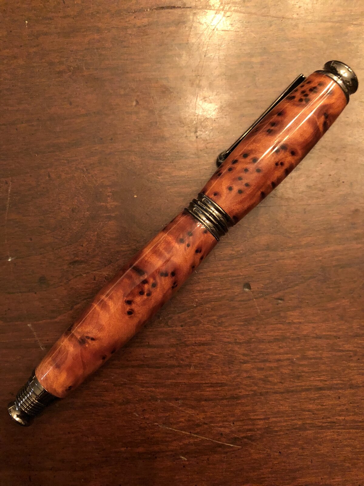

I have to say, you guys who recommended gluboost (particularly the accelorator with my mercury CA)…I am a convert! used it to finish two pens- no fogging, faster coats, fewer coats, and a whole lot less time.
Here's the Thuya Burl Virage I turned last night:
