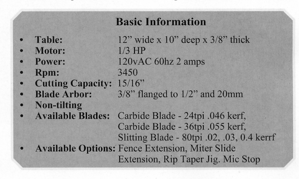

See the picture, taken from an online review. My question is specifically about the arbor size. The review says it has a 3/8 arbor flanged to 1/2 inch and 20 mm. Now there's quite a difference between 1/2 inch and 20 mm. I was thinking it meant the stabilizing washers were reversible or something. I took my blade off and I don't see how you could use a 20 mm blade without an adapter. Am I missing something?

I asked this of Donna last year - here is what I got back:
"If the 4 3/8" blade you have has a ½" opening, you do not need an adapter. Our arbor is ½" and this blade would fit right on the arbor.
If the 4 3/8" blade has a larger hole than ½" then Jim can make you an adapter any size ranging from 5/8" to 1" and that adapter can be ordered thru the website, you just have to specify the size you need.
Donna
