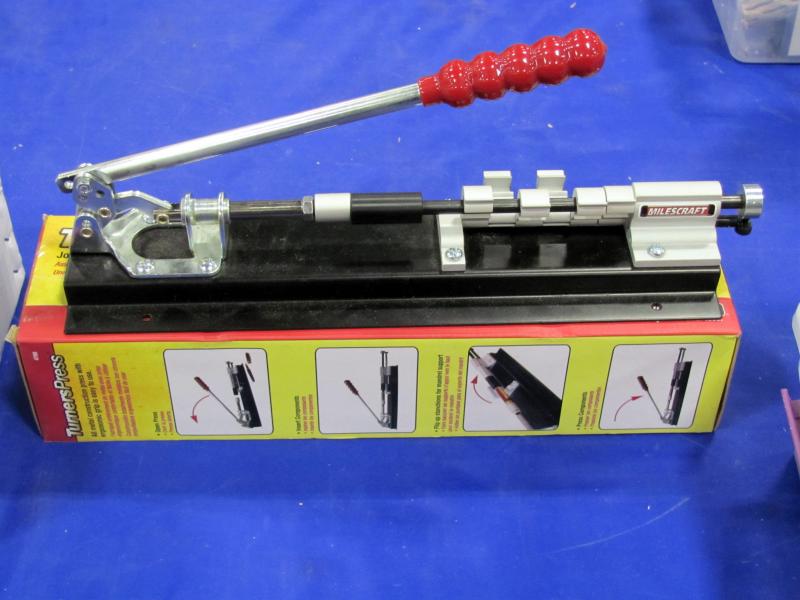

The one I now use is the one from Miles Craft and a video can be seen at Milescraft Turners Pen Press Presented by Woodcraft - YouTube . Many vendors sell it. I got mine from Ariozona Silhouette but it is available from Amazon. Today I saw one at Woodcraft in Ft. Worth.
I recently used this pen press continuously for two days and it never missed a beat.

Was using a Zyliss, but after trying the MilesCraft, I don't think you could find an easier or more efficient press. Instantly adjustable, spring loaded and can press a slim transmission the perfect length in one shot. The Zyliss is back in the drawer.

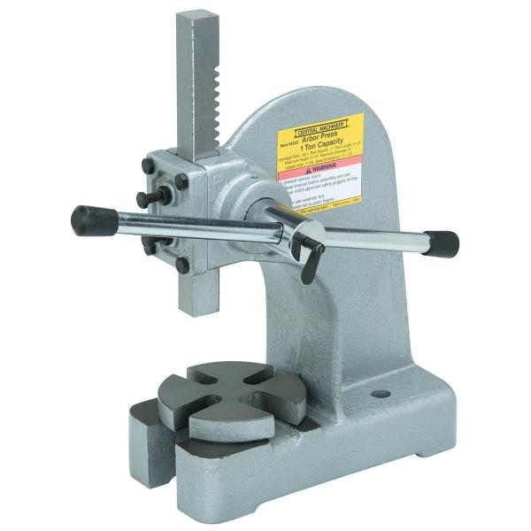

Arbor press from harbor freight here, very reasonable. I also cut a all piece of hard rubber and gorilla glued it to each side of the press so that the steel doesn't mar the pens I make.

This is the same one I use. Picked it up from Woodcraft almost a year ago. No problems with it at all. A pen press is not 100% neccessary, but it made things easier for me.
I have the MilesCraft press and have been very happy with it. Just make sure to put something soft on the ends of the press (leather would be good).

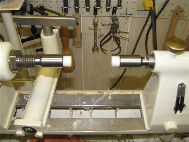

However, I saw a thread recently where you can use your headstock and tailstock to press pen parts together. It showed a plastic insert for each but you could just as easily turn a couple of pieces of wood to fit. Should work fine too.

After having ruined a few poorly aligned ( operator error) assemblies, I got the Milescraft...........won't look back, it's the cat's meow!
