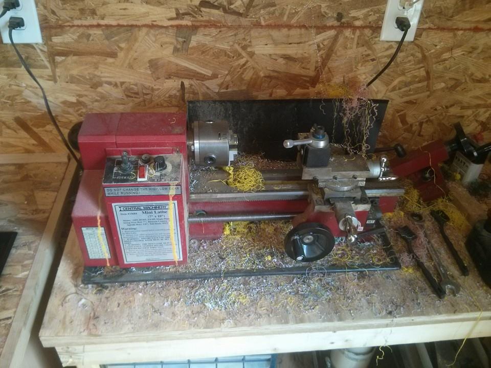

I have a HF 7x10 currently that already has a quick change post and upgraded gears in the head stock. I was considering saving up for the SEIG 7x14 that LMS has but I'm thinking ultimately it's the same system I already have with a few more bells and whistles.
Curious if buying a bed extension to bring mine out to 16" and adding a few other goodies such as a cam lock on the tail stock might be money better spent.
Any thoughts on the matter?

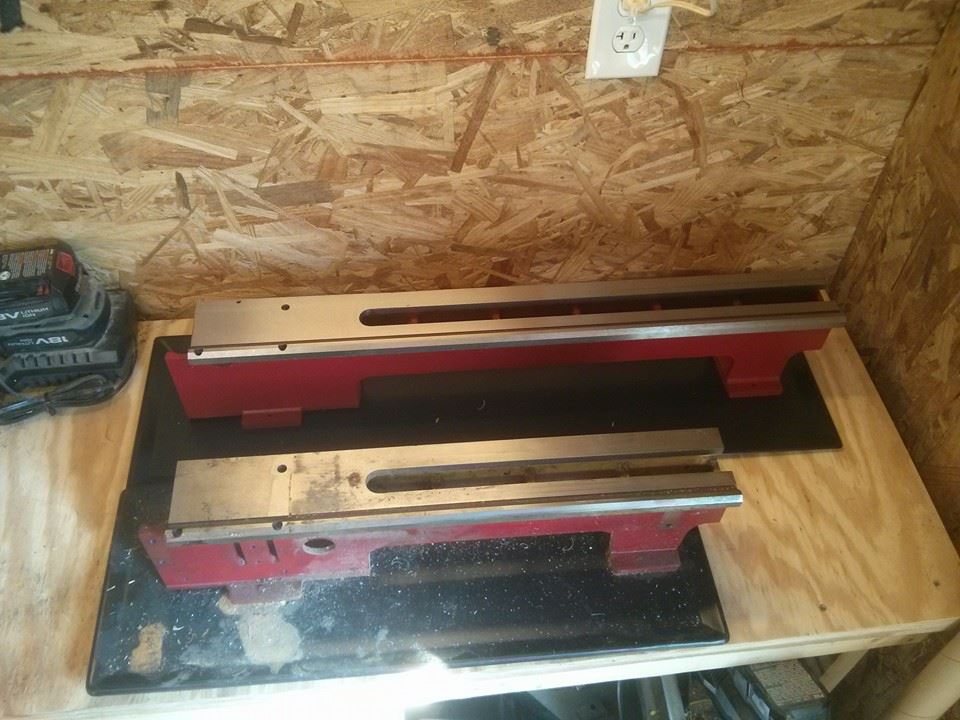

Correct, it's a full bed replacement that bumps you up to a 7x16 solid unit.
I also picked up a new tail stock with a cam lock to solve one of my other huge gripes about this little unit.
Drilling and tapping shouldn't be a big issue. I'll make a drill/tap block to hold everything at the right angle. 9 holes should be straight forward.
I put a 12 inch bed on my original 7x10 years ago (that was the only extended bed available) and had no difficulty with it, it really isn't that hard to do. If you have the skills and mechanical understanding to be proficient at using your lathe you are probably of a nature that will have no problem with the conversion.

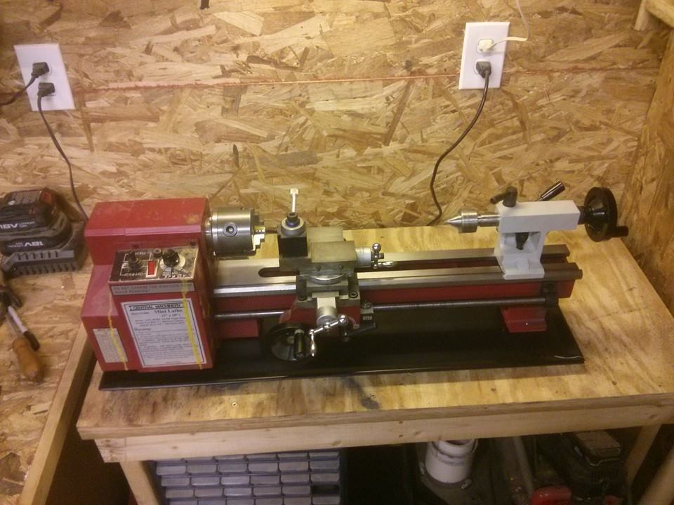

And here is the end result.
May not look like much, but I gained almost double my usable between centers work area. Happy dance.
Now to get some DRO setup.

Good job Carl! Apparently not that big of a deal. Get to work now.:wink::biggrin:
HaHa! Listen to me. Who hasn't made a kitless pen in over a year
Ok, having an extended bed is seriously nice and a must have. I don't know how I ever was able to live with the small 10" bed which really was only about 8" of usable area between centers.
I had to do some futzing with the tail stock alignment to get rid of a taper in the cut, but now that everything appears to be inline, I'm loving working on this big little machine.

Well, I couldn't pass up the deal on the used 7x10 knowing it was too small. Upgrading the size made it big enough for any pen related operation I can think of.
That finished setup looks sweet. It's making me think I need to start paying closer attention to craigslist...
