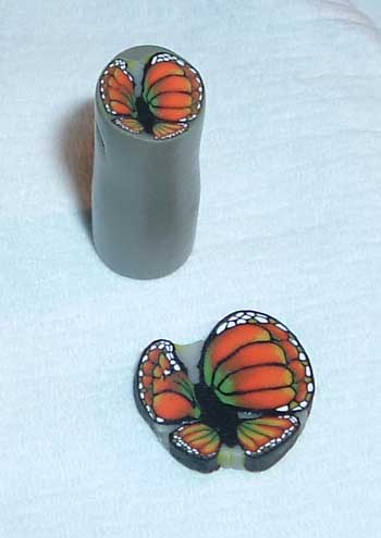

You might look at this and think it is an interesting effect.
Like the butterfly is viewed sideways.
I sure wish I could say it was on purpose!:rolleyes:
Me thinks I know why this happened but I'll need to try a few more to prove it out. All-in-all I like the way it looks and will try to incorporate them in a collage for a pen blank.
But really though, it was initially very disappointing considering all the work that went into making that cane!:mad:

I believe what happened here is that one of the larger wing sections was a bit longer when I began reducing the assembly. What that did was offer more resistance to the process and caused the other parts to reduce quicker. The center, so to speak, shifted and caused this effect.
I have since created 2 more rose canes and in both cases I trimmed the ends before I began reducing them.
Both came out just fine.
I still need to do another butterfly to be sure I can reduce it properly.

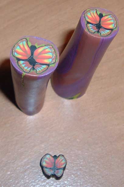

BTW, I tried using playdoh as a shield and then scrap clay like I saw in some videos. I am testing the same process using crayola model magic clay. This stuff is no good for making canes because you cannot cut it like PC. However, it seems that it will not stick to PC even as it is drying. I tried one this morning using it so I am anxious to see if it works as well. I don't much care for playdoh!
This one turned out as intended.
The model magic clay seems to be a problem. It is so soft that it gets into some of the crevices and is difficult to remove. May have to look for something else!
