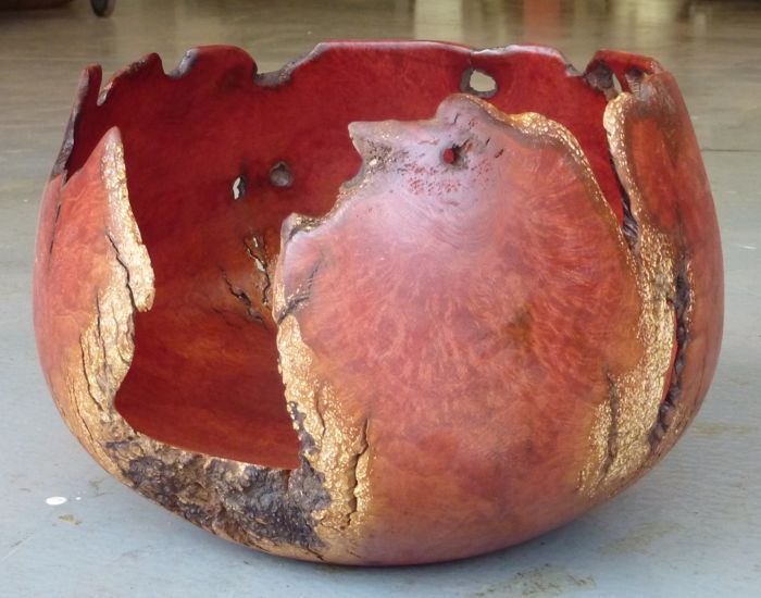

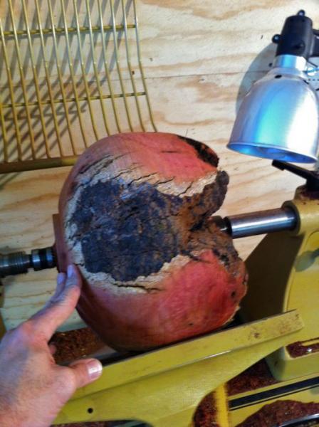

What do you do when you have a big lathe and someone gives you a butt-ugly root-stump of a local shrub bush??
attachment.php
Well, if you are me you wear yourself out for the last 4 days and turn it into a bowl.
attachment.php
attachment.php
attachment.php
attachment.php
attachment.php
attachment.php
attachment.php

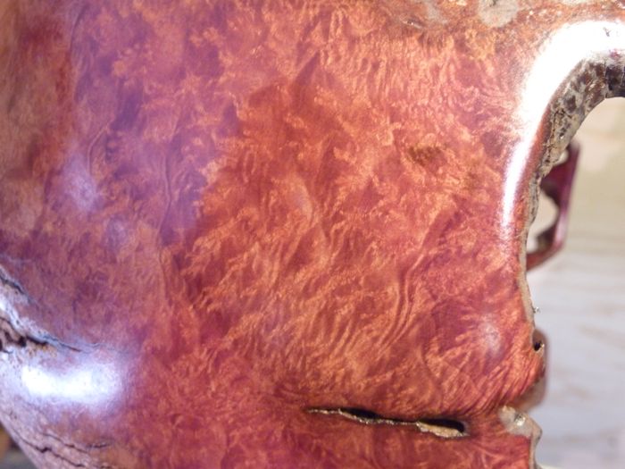

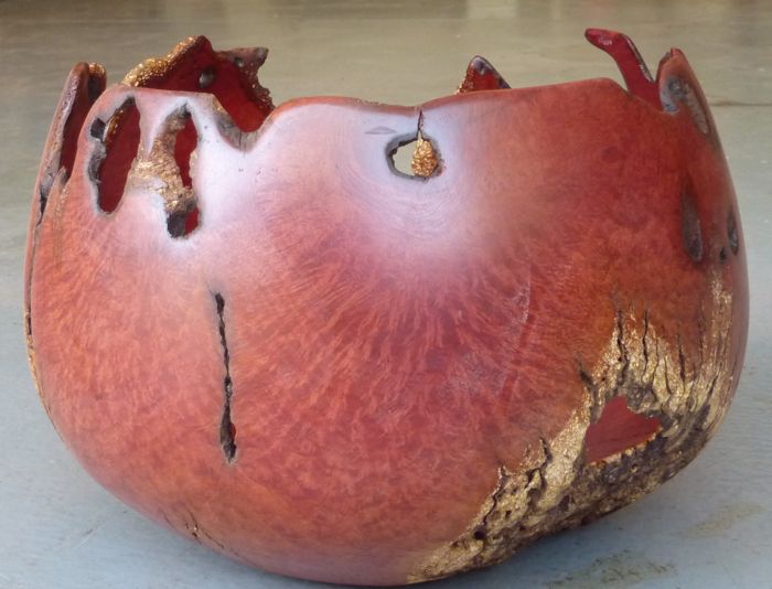

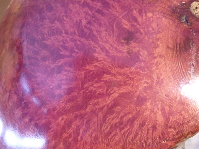

Manzanita root burl. 12 inches in diameter, 9 inches tall. And some of the most stunning wood grain I've ever seen.
attachment.php
attachment.php
It isn't complete yet, it only has sanding sealer on it. The base is a bit thick so needs to finish drying before I can final-sand it and finish it. Right now it is sitting sealed up in a paper bag to control how fast it dries to try to minimize cracking.

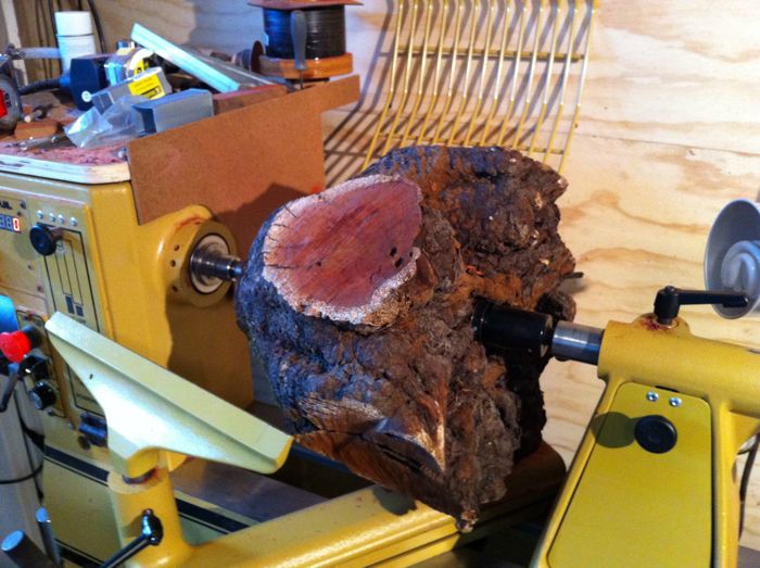

I'd be interested in hearing the chucking strategy for that.
Initially I turned between centers using a multi-tooth drive spur on the head stock and a point on the tail stock. Turned a tenon at this point.
attachment.php

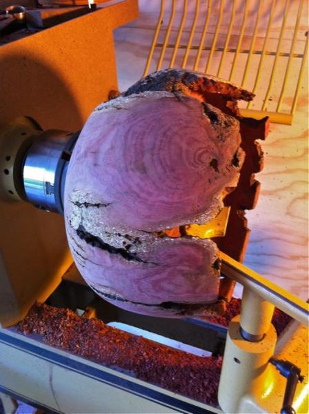

Stuck the tenon in Stonghold chuck using #3 jaws.

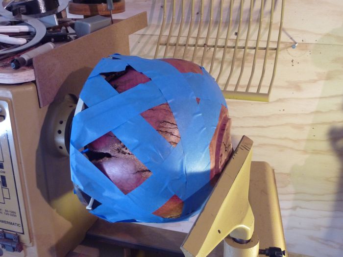

One big hint I was given and used. When turning the inside I first wrapped the outside completely in Blue masking tape and followed that with many many layers of duct tape. This to prevent those thin walls from flying off the bowl as it spins. Blue tape because it comes off easily, duct tape for strength.

Did you support the outside when you hollowed out the inside? Tape?
Indeed. When turning the inside I first wrapped the outside completely in Blue masking tape and followed that with many many layers of duct tape. This to prevent those thin walls from flying off the bowl as it spins. Blue tape because it comes off easily, duct tape for strength.

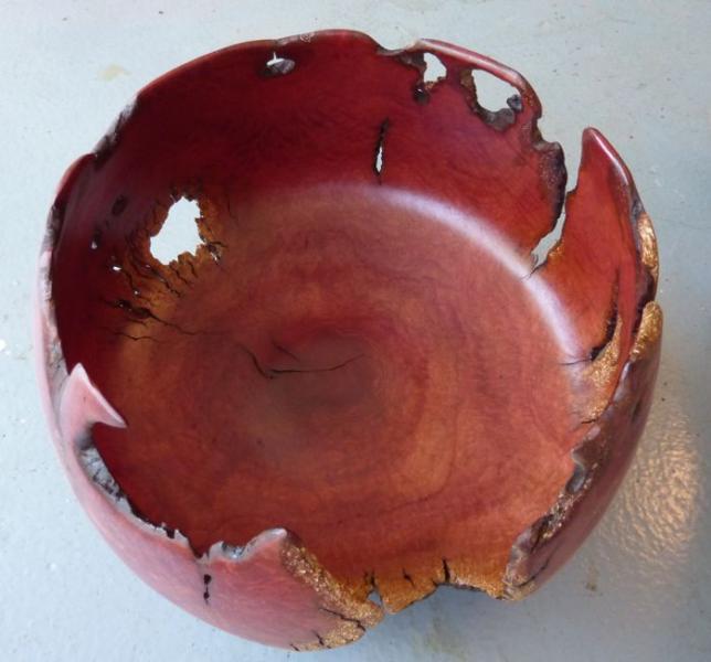

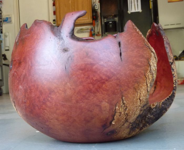

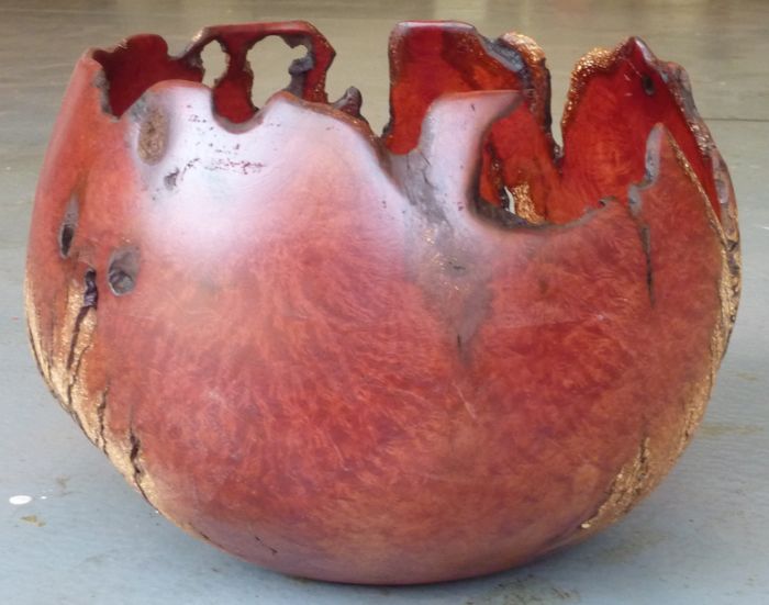

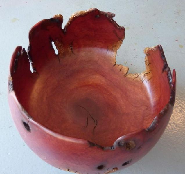

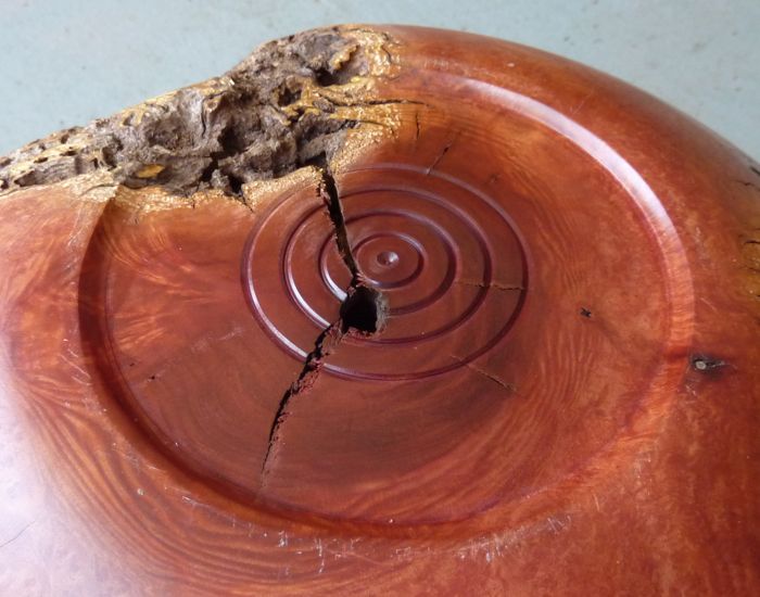

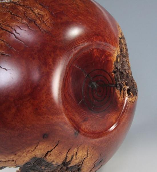

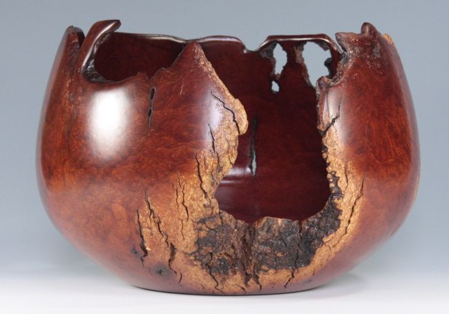

Final Photos for posterity.
Finished with 6 coats of Deft spray gloss lacquer and 1 coat satin lacquer.
attachment.php
attachment.php
attachment.php
The cracks on the bottom were filled with epoxy mixed with coffee grounds.
