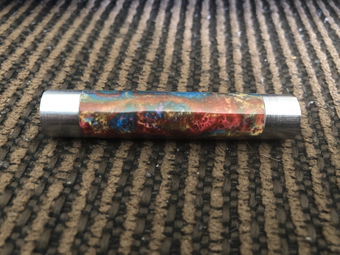

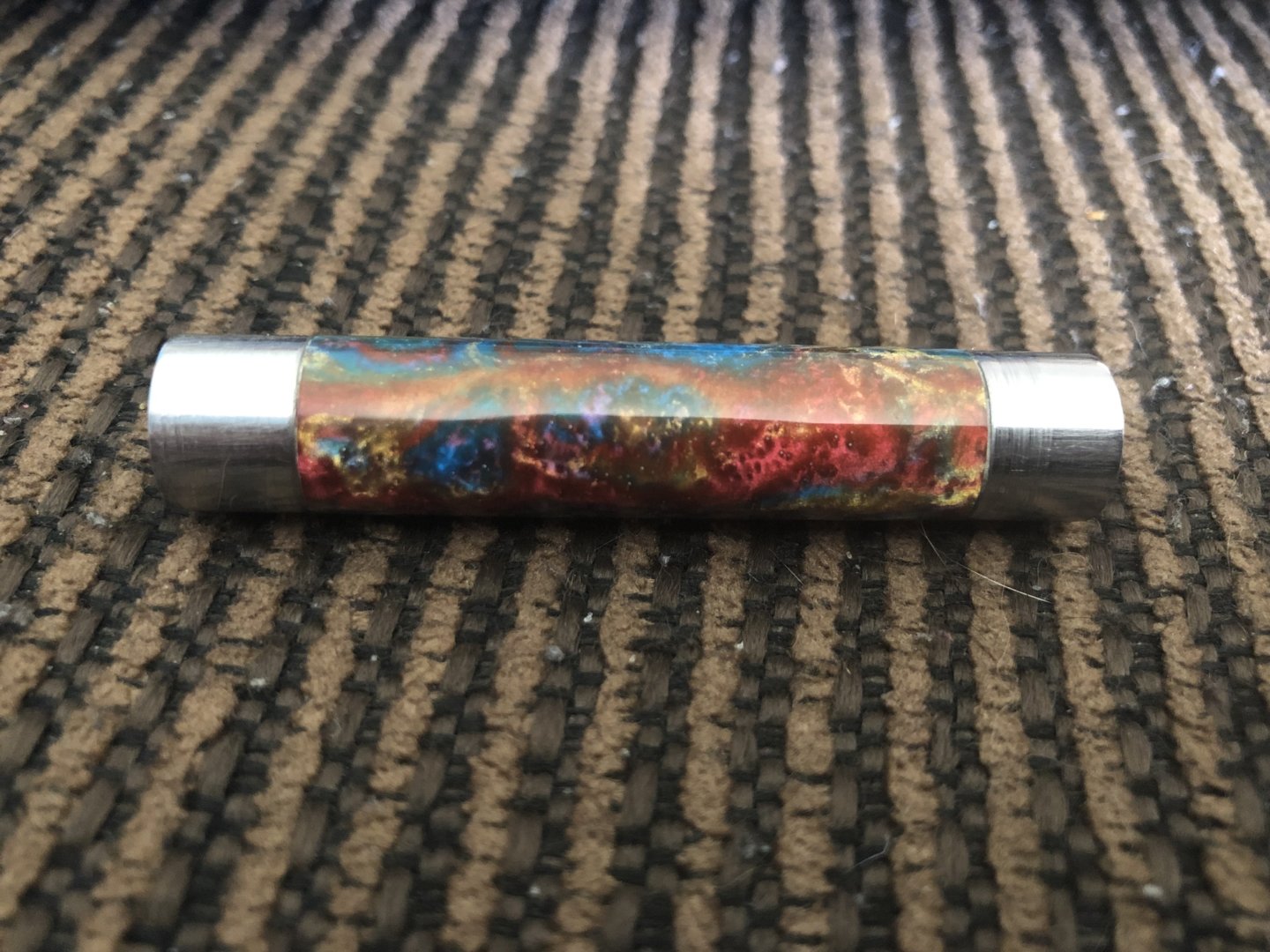

Hi there! I just got done turning and finishing a blank for a Wall Street II Pencil Kit. When I took the blank off the lathe, I couldn't get the bushings out of the blank! I'm guessing this is from one of the following reasons....
1) The CA glue wasn't all the way dry. (Which I doubt because I waited about 15-20 min before mounting the blank on my lathe)
or
2) When I was using my pen mill, I might have gone down a bit too far and flattened the end of the tube by the smallest bit, making it a much tighter fit on the bushings.
In either case, I need to save my blank! It's my first blank I've ever casted myself and I want to do everything I can to save it! Any tips/tricks/advice would be greatly appreciated!
Crisis averted! Sorry for the premature panic! I don't know why I didn't think of this earlier but I ended up taking a punch that was slightly smaller than the hole of the bushings and hammering it out at an angle. I think I ruined my bushings but it's a small price to pay to save the blank!
Get two 1/4" drill bits and put the butt ends into the bushings. . Hold onto the drill bits and wiggle them oppositely. . You can be quite forceful, but don't overdo it. . Keep wiggling for as long as you can. . This should weaken/loosen a possible CA bond between the bushings and the end of your blank. . The wiggling should also free up a jam of brass crud if your other suggestion is the problem. . Good luck ... you will get the bushings out !
Edit: . Glad to hear that you freed things up !
Glad you were able to get it apart.
A couple other tidbits. When done with sanding the blank down to the tube end or using an pen mill, alway take a file or reamer and ream the ends of the tube to deburr the ends. Always do this. I do it then and also just before I insert the components to make sure there are no burrs and either the bushings slide in easier or the components do. This is important. Also check the inside of the tube to make sure there is no glue inside. Again very important.
Another tip is use a good set of calipers and check the ends of the blank with the components and do not trust the bushings for size. This will get you in the habit of taking the blank off the lathe and taking the bushings out to get a nice measurement. Then if need be reassemble and do it again taking off little at a time.
Another suggestion - buy a 6MM rat tail file. use it to get rid of glue and burred ends of the tube caused by excessive barrel trimming. They are less expensive than a pen tube chamfering tool at $19.
