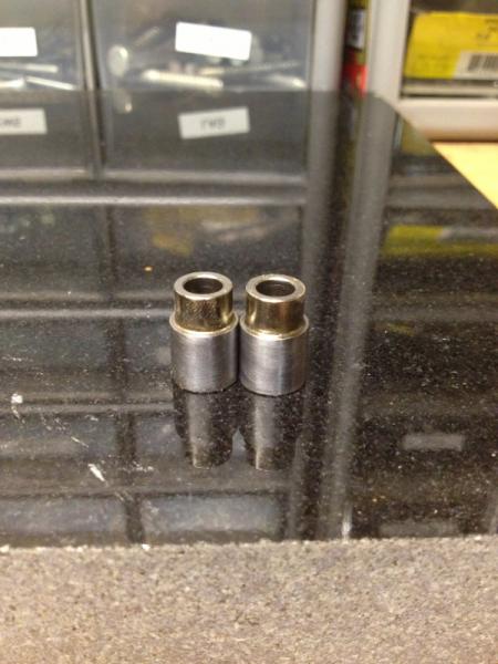

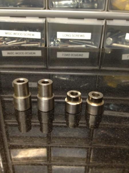

Hi Dan,
I will pm you as we'll, but wanted to share a couple of photos.
There are three vertex models and I believe all have different bushings. The one in talking about has the magnetic metal cap.
Here is a pic of the stock bushings and then a pic of stock bushings from another kit as well as the same from penturnersproducts (who doesn't make this one).
I don't really care how its make, but his are longer on both ends an I believe are tighter inside the tube.

Are you sure those are from penturnersproducts? All of mine from him are solid with just the 60 degree cut for the centers. I think the ones from lazerlines are drilled through though. either way, I agree with you. the ones from penturnersproducts are top notch, as are the ones from lazerlines.
About the only suggestion I'd make is to contact some of the members here who do metal turning, and see if they'll make you a set. Might cost a bit more, but if that's what you make a lot of, it might be money well spent.
If Johnny (penturnersproducts) isn't available, I'd drop Constant (Laserlinez) an email. Either can likely knock them out in short order, but may need you to send him a kit to get accurate measurements off of.

I'm sorry. You are correct - that set is from kazerlinez
