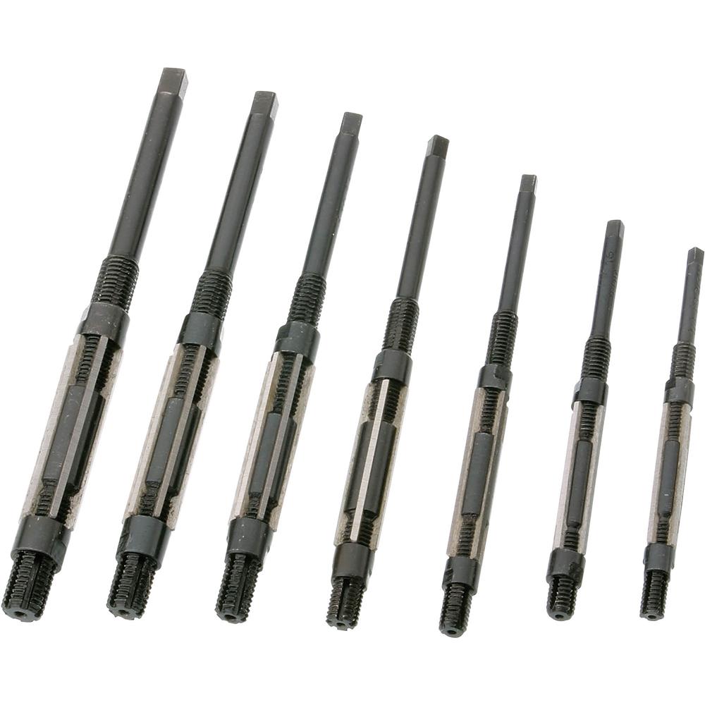

But one thing that you should stock and don't (as far as I know) is a set of straight-sided adjustable reamers.
I use such reamers ALL the time to clean out the brass tubes in preparation for assembly.
I know that a barrel trimmer can be used, but they are not nearly as generally useful as an adjustable reamer which isn't much more expensive.
I am thinking of the Grizzly set (and some places sell them individually):
I buy mine in Canada from BusyBeeTools.com and also from KBCTools.com
