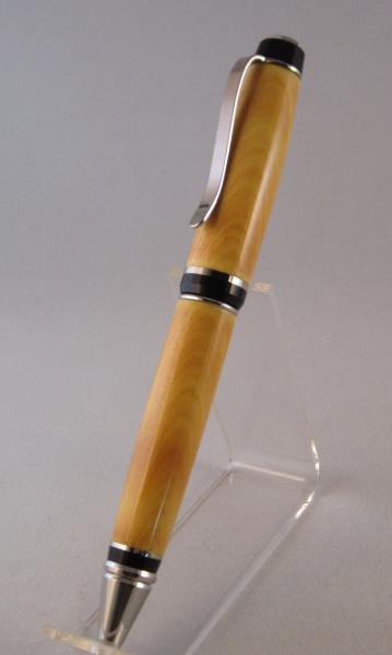

I turned a peicce of orange - really plain wood - before putting on the CA I used my propane torch and with the blanck running at high speed I gently "torched" the wood. Be sure to not stay in one spot (DAMHIKT) - move rapidly back and forth - be patient. I produced what I called a Toasted Orange Cigar!

well i guess i really don't need to comment here do i. i got so excited when i read the thread and actually had something to share for a change. i was even more excited to see that my work was not only remembered but found and posted. thanks. but i will add that i would finish it with some sort of clear. if you have ever handled a piece of burnt wood you will under stand. the one shone is ca.
