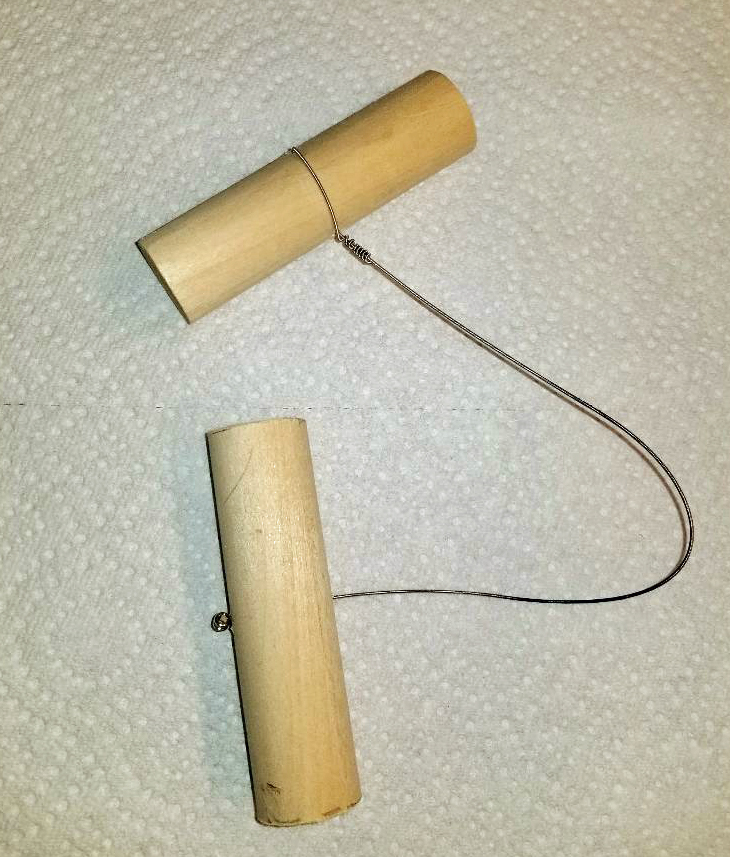

Made my own from guitar strings. I have used formica mounted on the end of a stick when our club would set up at the state fair and let people turn. I think the formica was a little safer than the strings because there is no chance of it wrapping up. The formica can be used to burn a wider section also or use it on edge and burn a line. I prefer the strings for lines seems to me to be faster and you can have a selection of sizes.

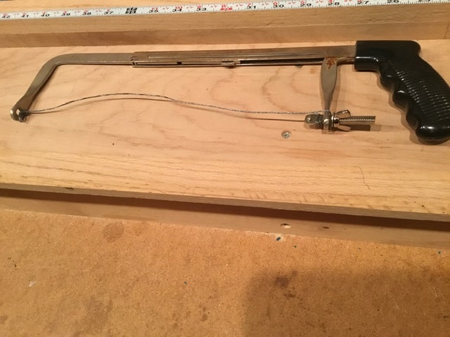

I have braided "windshield remover" wire...might try attached to dowels. However will look into guitar strings. Thanks everyone.
I just used a galvanized wire I had in the shop, no handles, nothing special. It works well on mesquite and oak but I'm sure I would have better results with guitar strings and the like. Given Bob's warning though, I'm going to make a proper wire with handles.
Absolutely use handles... dowels... whatever. I thank BOB for posting that. Safety first each and every time.
