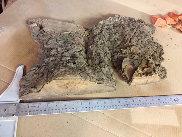

Hey all,

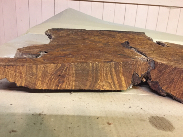

Still new to the forum so hopefully I'm not posting in the wrong spot, but I was given a piece of Burl that was harvested in the 1930s. A couple questions: I was going to try to make some pen blanks out of it - any tips or anything I should be aware of?
Also, can anyone identify the wood? I think it might be red oak based on the one picture from harvesting the Burl, but not sure if anyone could tell just from the Burl? I could probably post a couple more pics later.

Most definitely NOT any kind of Oak.
I would guess at some type of Mesquite or Cocobolo ... leaning towards the latter, as Mesquite doesn't quite grow very large.
How hard and dense is it? There doesn't appear to be any sapwood between the heart of the burl and the bark, though that might not be a common occurrence if it's a bark inclusion.

Interesting. I should also note that it was harvested in southwest Washington.
It's pretty hard, but not super dense. It's also really dry though.

Very tough to guess woods. But if I were to venture a guess it wood be a walnut burl wood. a realy rare piece.

Probably big leaf maple , although from the harvesting picture I would have thought there would be a bit of sapwood on the outer edges . Also darker than normal but 80 years of aging could do that . If you could sand some of the face and edge grain to about 400 grit , it would remove some of the oxidized layer and give a better look at it .
If it were walnut , it would have the characteristic walnut smell when sanded .

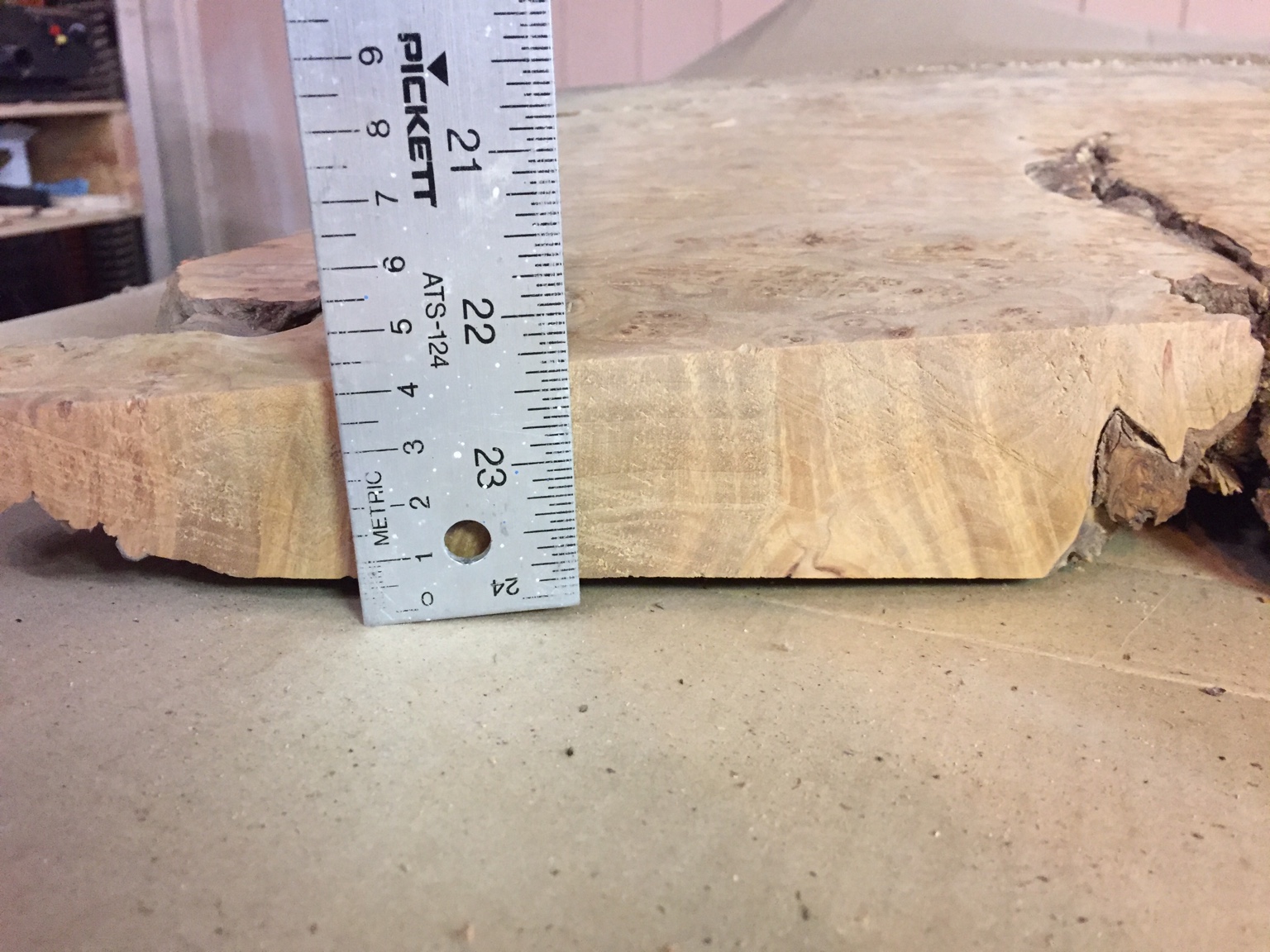

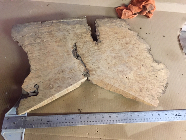

Never would have guessed maple from that color ... but yeah, it's a very old piece of wood ... Hit the edge and face with some 120 and work your way up to 400 (less work) and then snap a few pics ... include a ruler next to it so we can give you some advice on which angles would be best to work! :)

Awesome! Thanks for the input. I'll sand it down and get some pictures with a ruler.

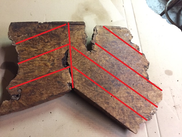

Once we can see the dimensions as well as the underlying grain, everybody will be able to have some idea of which directions it may be best to cut it in ... probably the best idea for processing it would be using a bandsaw, as a tablesaw's larger kerf would mean more wasted wood.
I see two flat areas on the edge of the burl .... my input will likely involve taking off the lesser left side flat area or simply splitting it up the middle where the angle meets, and then putting the flat sides against a fence on the bandsaw to cut your blanks to size. See picture for a visual of this idea ... obviously, the size of the cuts you make depends on the actual size of the material you have.
attachment.php
If you are needing normal sized pen blanks for smaller pens, then 5/8ths to 3/4ths would be ideal ... if you are wanting oversized pen blanks for larger pens, then go to 7/8ths up to 1 inch squared for your blank size.
I would also highly recommend that if you are CLOSE to the proper depth of cut but a little over, use the bandsaw and fence combination to slice away some veneer and save it for later use. Doing this before cutting it down to the small pen blank sizes would be best, if you can manage it.

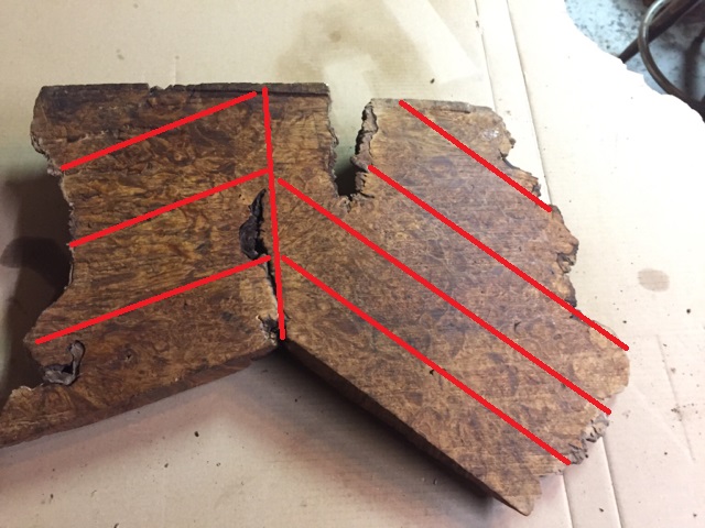

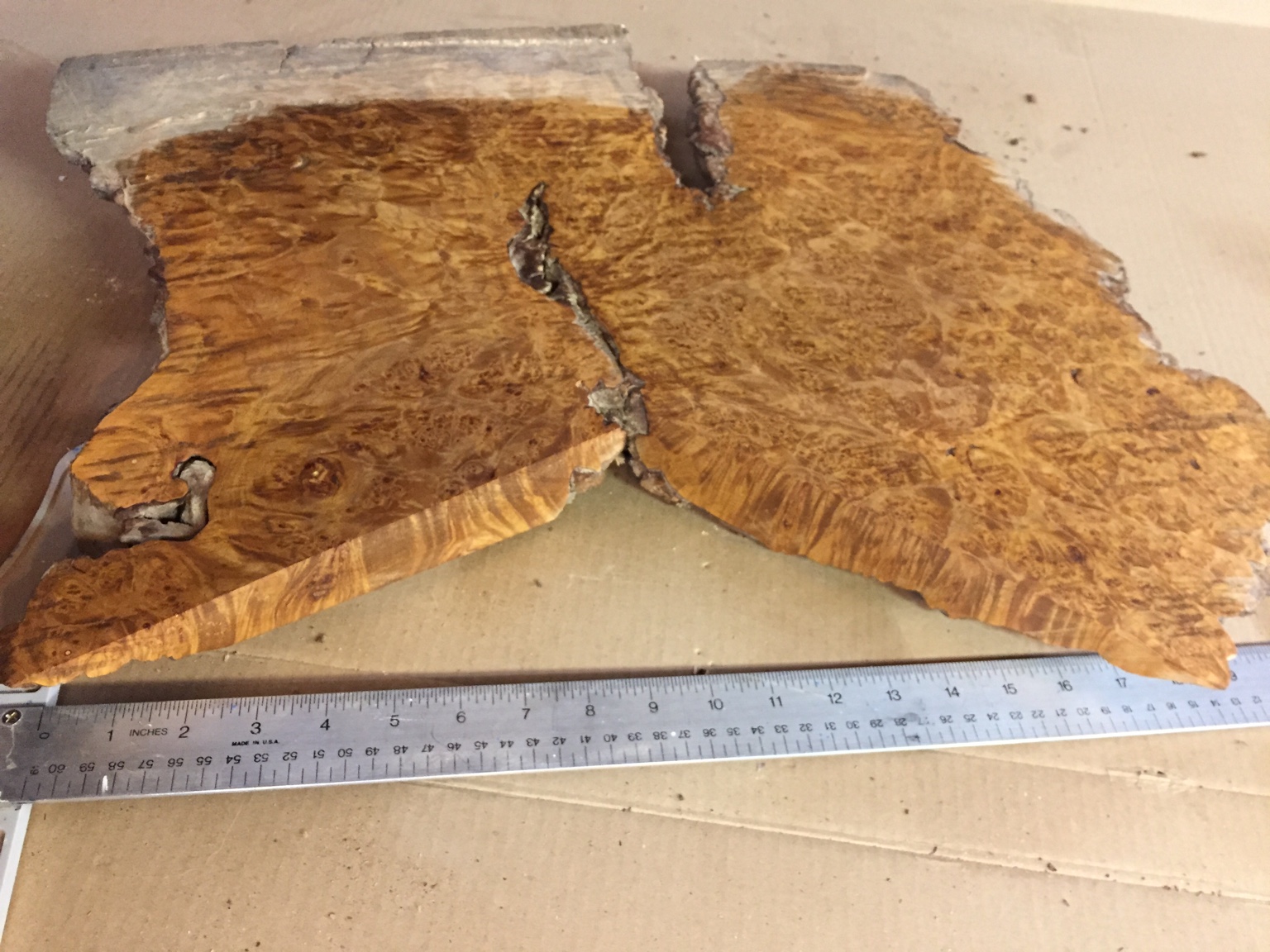

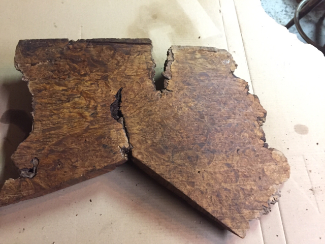

Thank you for the explanation and visuals! That helps a lot. Unfortunately the piece is pretty curved, but if I cut it in half like you show, each half is a lot closer to level than the whole.
I sanded it down to 400 and also used some mineral spirits to wet it down some for a picture.
Definitely excited to get such a great piece of wood. I think I'll practice quite a bit more before turning a pen from this...

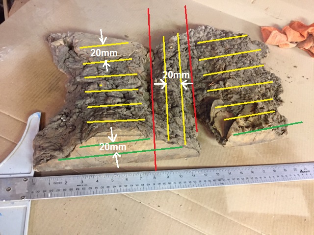

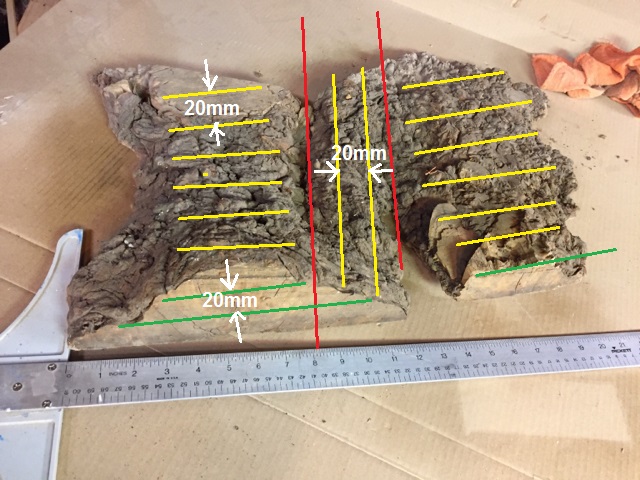

The burl is not from around my neck of the woods and I'm most surprised that you have a pic of these burl being cut all that long ago, that is priceless.
If pen blanks is what you want to get out of it, knowing now what the underside of that slice looks like, my suggestion to where and how that piece should be cut, is explained in the pic attached.
After you got it divided into the 3 pieces and then sliced at approx. 20mm slices/boards, you can then slice them again at 20mm and then decided where to cut to get you pen blanks from, all the edges could be used to make hybrid/cast blanks and use the whole thing, absolutely no waste.
Best of luck...!

You have more wood there than I thought . I would start with George`s first two cuts . Then , you have to decide whether you want all pen blanks or a mix of pen blanks and larger pieces . The thickness would allow larger items to be made , such as bottle stoppers or S&P shakers . As George said , all of it can be used . Potential for lots of nice castings .
Looks like the colour will be very close to Rob`s picture .

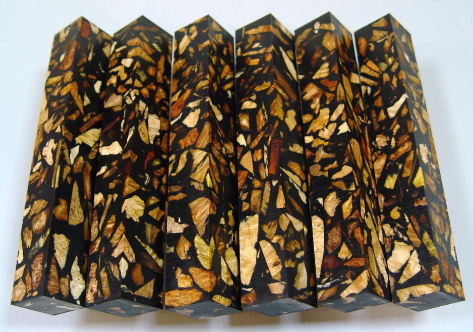

Hmmm ... went poking around a few sites .... this is a "mixed mutt" blank with bits and pieces suspended in a black resin, I don't see any bark included.

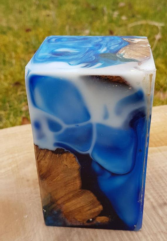

This blank on Etsy appears to have had it's bark left on ... it's a bottle stopper sized blank, 6 cm x 6.5 cm x 11.5 cm...
So ... I guess it depends on the preference of the maker and end user, ultimately, as to which is preferred ... but in order to give the best choice, I'ld leave the bark on and send it on to whoever's making the blank, and let them choose whether to remove the bark or include it.
In that bottle stopper sized blank, there are two pieces of burl ... the larger one is bottom left, smaller one tucked top right. (This item is not mine, just grabbed a random link off the search page and came across this image.)

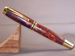

Found a few pictures . First is big leaf maple , not a burl but with a type of spalting that it sometimes has , tung oil sealer finish ; second is Diamond willow , totally natural edge , bark and orange pincushion lichen adhere tightly , but used thin CA on them to be sure ; third is Saskatoon , part of the bark natural edge , part partially turned through , bark is held very tightly but may have assisted it with CA in a place or two , tung oil sealer finish
