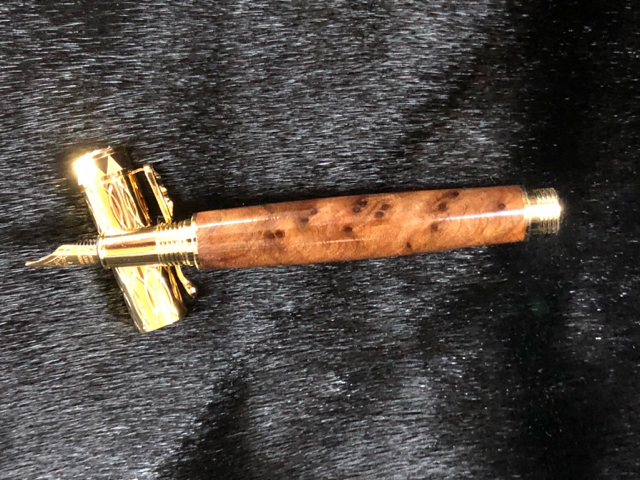

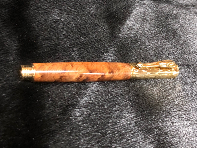

So, I fixed the problem by changing to Mercury Adhesive's flex CA. (Thin and Medium viscosity.)
I also slowed the lathe to about 600RPM with my hand slightly right after applying each coat. (5-10 Seconds total.) My Revo 18/36 arrives tomorrow so I shouldn't have to worry about slowing the RPM by hand much longer. :)
My photography skills suck but here is an Electra Pen I made tonight:
