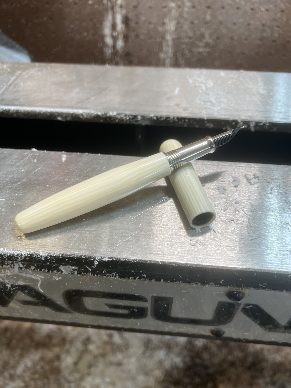

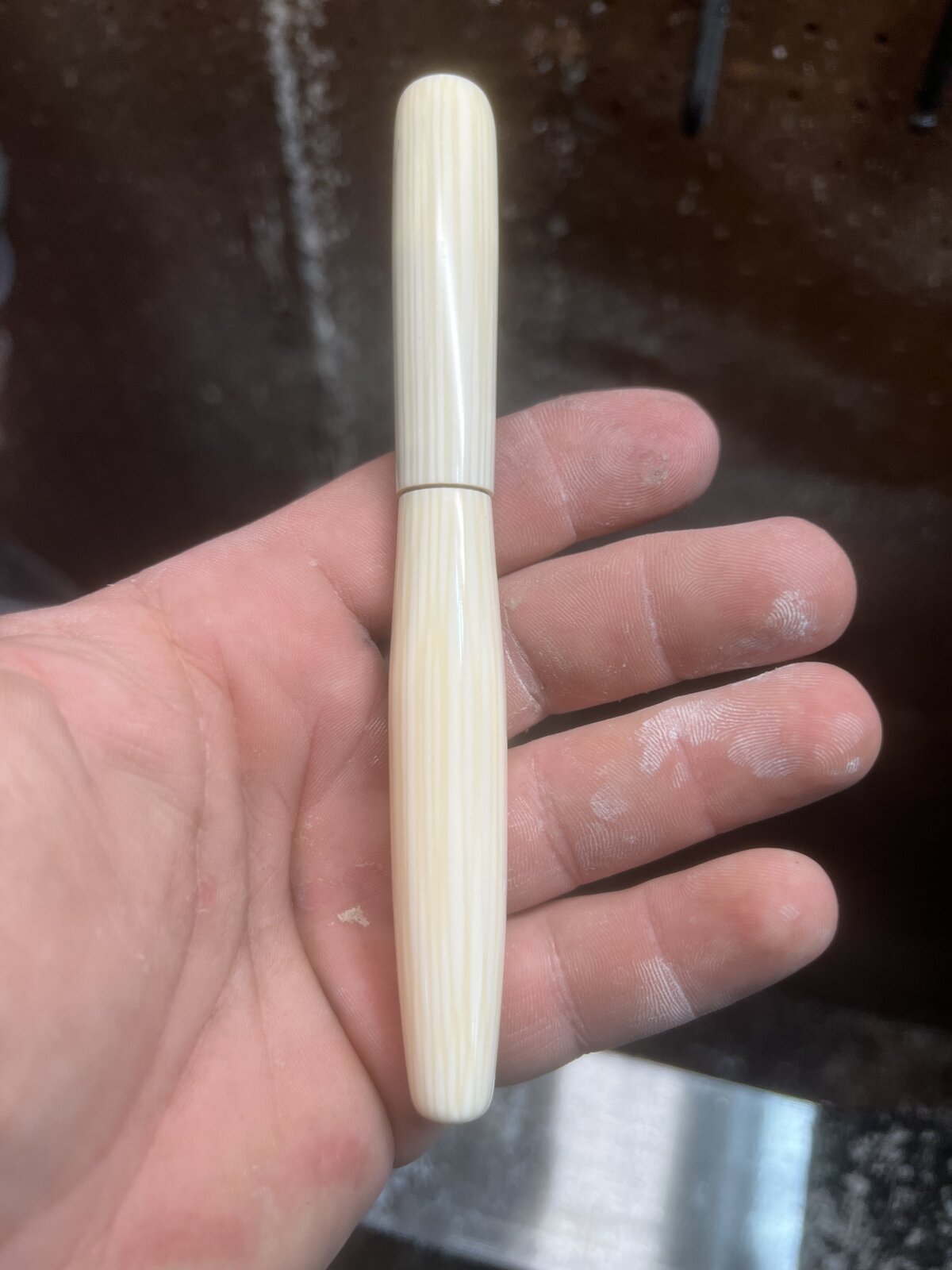

I got the kits this weekend and turned the first one yesterday. Yes, I know I've got some issues to work out, first time using these kits and this material so this pen will likely just stay with me. But I do love the kits. Will be looking at getting some more

View attachment 376109I got the kits this weekend and turned the first one yesterday. Yes, I know I've got some issues to work out, first time using these kits and this material so this pen will likely just stay with me. But I do love the kits. Will be looking at getting some more
That looks great! Great job on the cap recess - that's the thing everyone messes up on the first one
The best part about the kit is that if you decide later that you want to change the profile, you just have to unscrew the section and pop it back on the lathe.
Thank you. These kits make it easy to make a great looking pen
