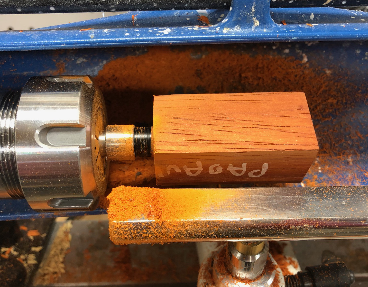

Thanks for the advice! I did drill the air release hole. I am guessing that my 1.05" hole is a little short. When I test fit and saw that the plastic insert was inside the edge of the blank, I assumed it would be a good fit.

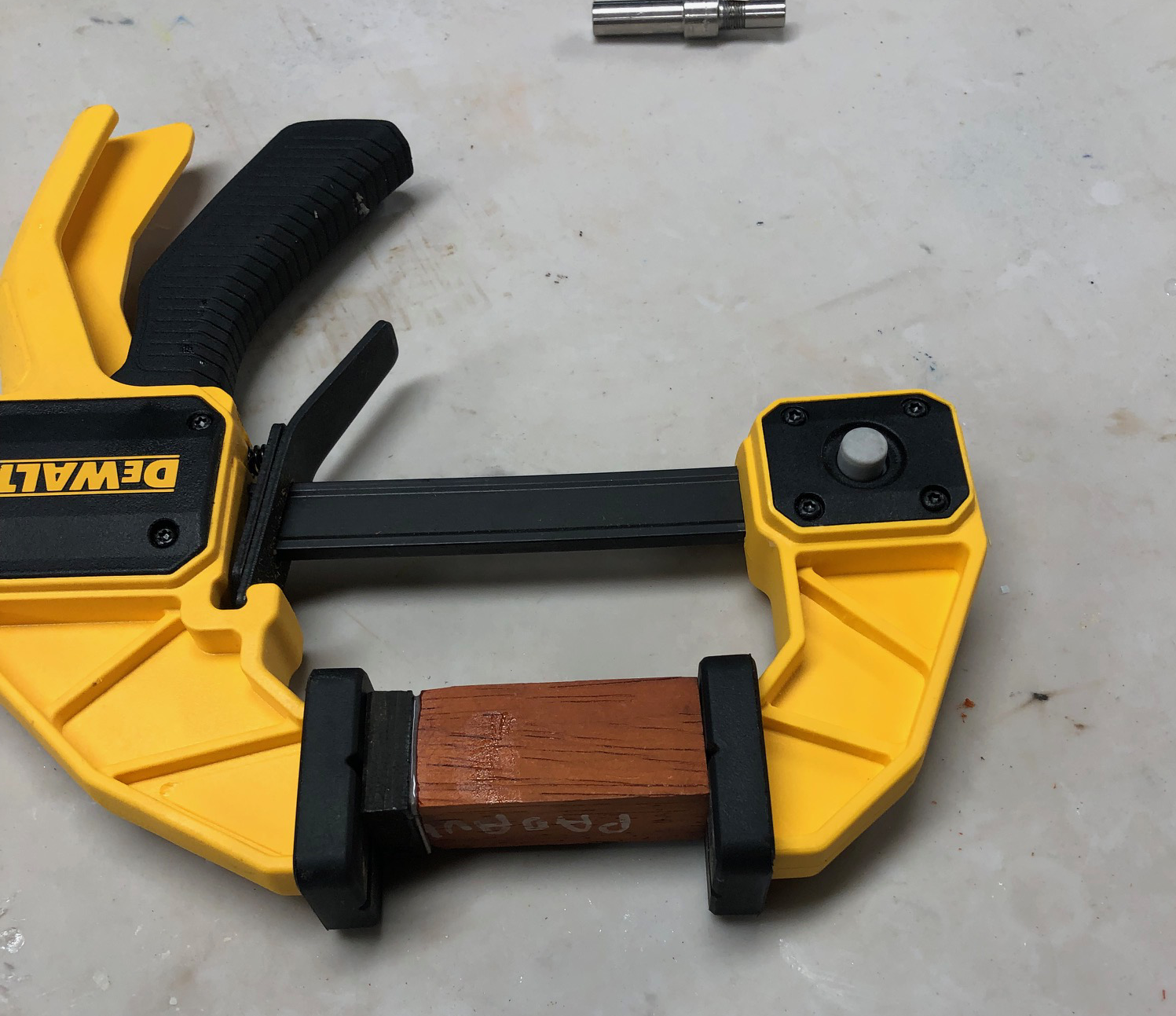

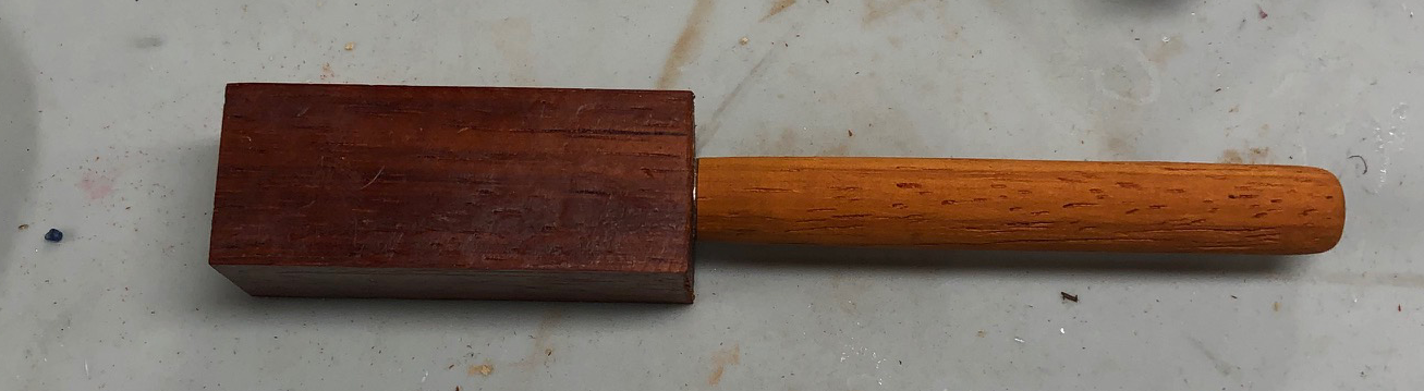

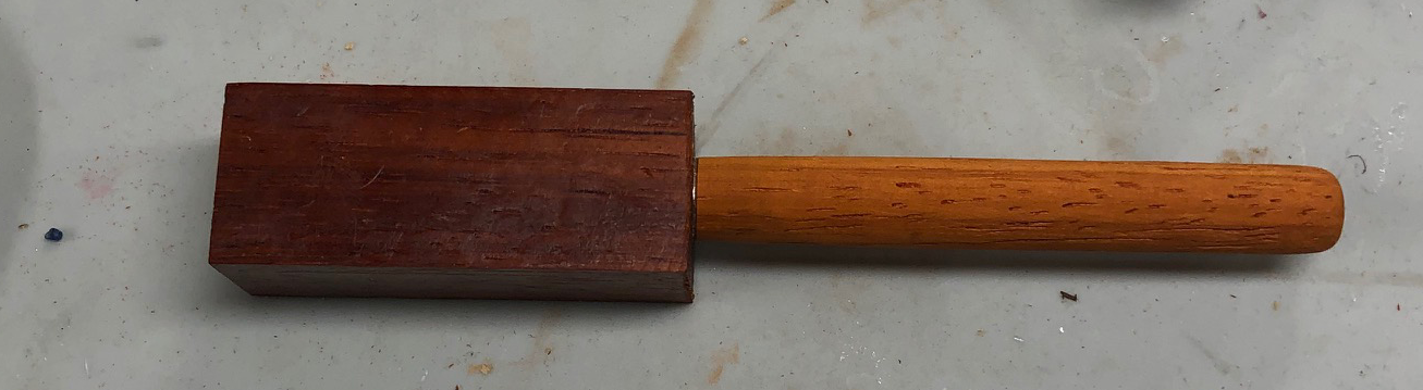

I have parted back to the plastic. I put in a piece of vulcanized fiberboard and then an ebony extension. Hoping that the fiber board will expand with epoxy and possibly hide any imperfections in my parting. Letting it dry now and will turn it down and report.
When I test fit the plastic insert, I have learned it needs to go in just a little further than you think it does. As you know, that little "weep" hole is crucial, otherwise it works just like a hydraulic piston.

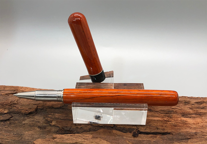

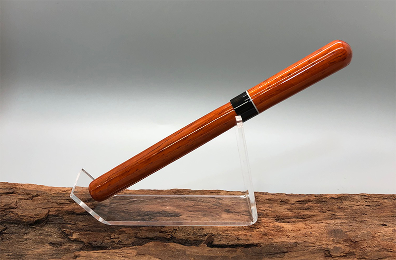

I think that was my issue. I figured it was okay but needed a bit extra. I feel it now hangs over about 1/8" and fits perfectly. I did chamfer the opening a bit, as Penchant recommended as well. The finished pen is below. Next one, I want to get the ends flatter, but I am thrilled with this kit and plan on ordering more. Thanks for the recovery assistance!
I did a few of these myself, and fortunately did some dry fitting beforehand to make sure the recess was where it needed to be. Having a slight recess and having the end dead square are key to make the fit match. The one thing I liked and disliked about the kit is that the threads are single thread, not triple but having single threads allowed me to have a constant, perfect match to the wood grains and highlights no matter how many times you open or close the cap (liked!). I'll get used to having to turn the cap a few more spins....lol. These kits are well made and fun to build - a great mid-way point to a full kitless pen. I really like your 'recovery' pen - I think the ebony adds a lot of class to it!
