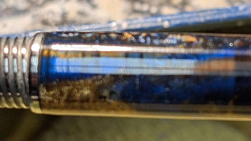

To circle back around to this, I will be painting mine in the future.
The focus on the shot didn't come in but the dark lines are the bands from the insert.
