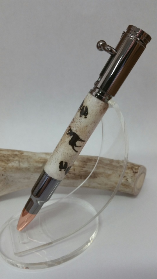

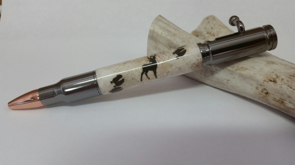

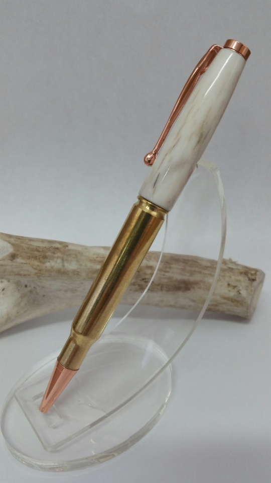

These are my first attempts at working with antler.
In the extremely long thread on the Neje laser, someone mentioned that you could laser engrave antler with it so I gave it a shot.

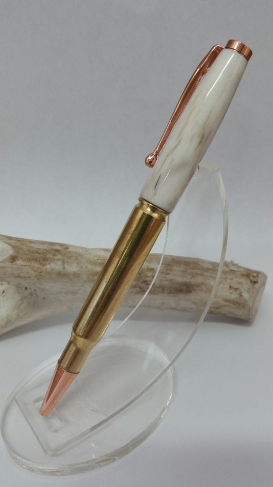

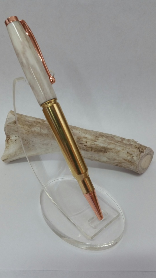

First one is just a 30-06 bullet pen with plain antler.
The second one is a Magnum Bolt Action with antler I engraved with the Neje.
Both with 8 coats of thin and 8 coats of medium CA.
A word of advice, if you are going to laser antler, make sure you have plenty of ventilation. That smoke stinks to high heaven.
That piece of antler was a little porous so the laser left the surface very uneven. Never could get it back very smooth.
Still looks OK though. I will have to refine my technique a little.

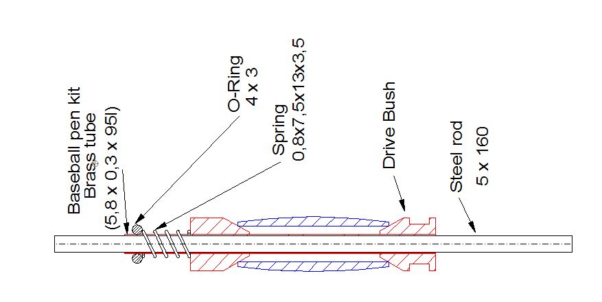

As for the jig, it looks to me like it is important for the drive shaft to be the same diameter as the pen. I am thinking it might work to use the pen bushings for the drive portion and a spare mandrel for the shaft... Just an idea.
Using the same size drive bushing will keep a 1 to 1 ratio on the vertical image size. You can shrink or enlarge the image vertically by changing that ratio via changing the drive bushing size. An example of that would be for an image that spirals completely around the pen more than 360 degrees.
For example: a pattern that runs on a 45 degree angle on the Neje software screen. If you had the drive bushing much smaller so that it is a 1:2 ratio you could have the image snake twice around the pen blank. That might be kind of cool for a set of paw prints or deer tracks.

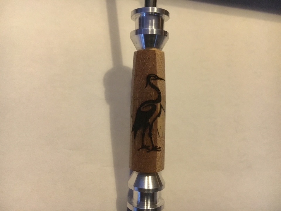

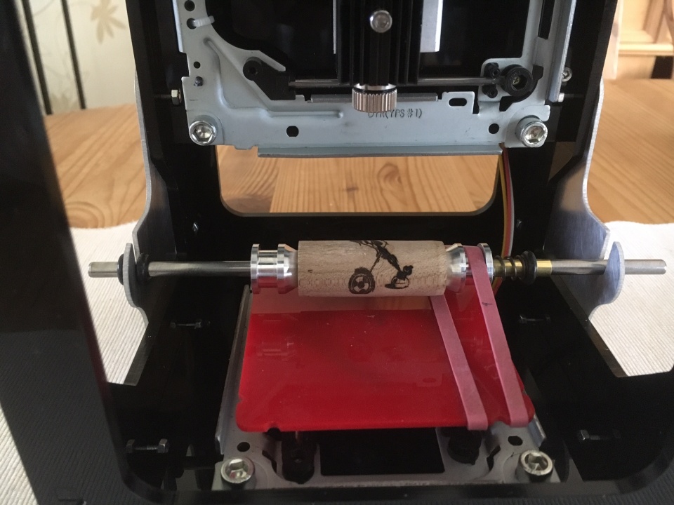

The first trials:
Great job. I will be building my jig this weekend. I like the thin metal frame. Does the blank spin freely on the shaft or is it a snug fit and the whole shaft spins in the jig? I figure whichever gives the least resistance.
Thanks for the link. I will definitely be building that jig. Will solve a lot of problems
The first trials:
Here is a pic showing the operation:
A drive bush is glued onto the brass tube, next the blank and second bush.
Then an O-ring holds the blank using the light pressure of the spring.
If you want the DXF for water cutting of the carriers, I can send it with a PM
