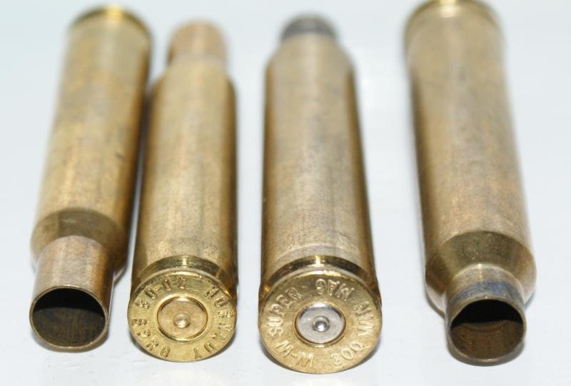

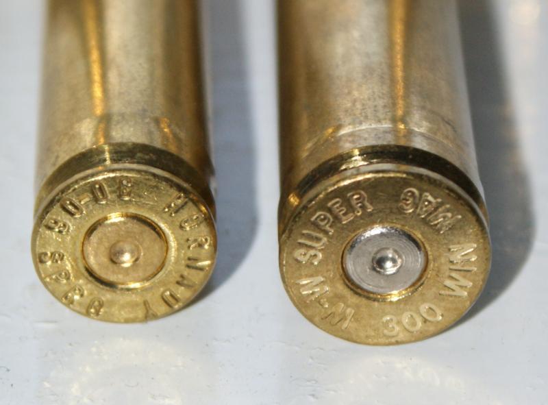

Can anyone tell me how to get the firing pin out the the bullet casings?

Don't even try it. Find someone that reloads ammo and they can remove it the safe way. You DO NOT have the means. You can buy them cheap enough ready for your needs without taking the chance.
I am so not a hunter. I get these from my nephew. I need to remove that round "thing" in with the dimple in order to drill a bigger hole to put a brass tube inside, right? How do I get this out?
Stop laughing at me

Ok they have been fired no problem. You need to punch it out from inside. Go to the dollar store and buy a set of real cheap jewelers screwdrivers. If you look down the inside of the brass casing you will see a little hole at the bottom. Pick the screwdriver that will fit through the hole. Set the casing on a board that has a small hole in it and then put the screwdriver through the small hole and hit it with a hammer, it will punch the spent primer out.
You can also use a small rod or anything else that will fit through the hole but I've found the cheap dollar store screwdrivers work great.
Don't do this with primers that have not been fired.
I hold them gently in a vise and drill them with two drill bits. First the small one and then the larger, usually a 7mm so that the tubing fits easily. I use a piece of shrink to fit tubing over the end of the tube prior to putting it into the tube then I then solder the tubing into the body. It only requires that you hold the tube gently and that you don't hold it while soldering it.

As long as the primer has a dimple in it, it is safe. If it does not it is more then likely live. Correctly stated, if a live primer goes off shrapnel will not fly but your ears may ring for a couple hours and your heart is gonna race for a while and your gonna need to find an outlet for the adrenaline dump you have just experienced. As a "hunter", "reloader" and "penturner" my advice would be the dollar general screwdriver mentioned earlier in the thread. If you're not sure if the primer is live, find someone who understands guns and bullets and seek their advise. Better yet find someone who reloads and have them de-prime the bullets for you. In the process tell them what you want it done for and I'm sure it will turn into a pen sale. Everytime I show mine off to a person in that crowd it ends up in a sale or 3. Kinda like Lays Potato chips, they can't eat just one.
Actually, there is no real need to punch out the primer at all (as long as you make sure it's been fired). Just put a layer or two of masking tape around the casing, put it in your scroll chuck or collet chuck BACKWARDS, and drill it out along with the pocket it sits in. The inside of the casing slopes to the center, and will guide the drill bit to the exact center. If you are using a 30 caliber casing, a 7mm drill will fit through the case neck, and it's one step to finished hole.
Usually, but not always. It is possible for a primer to not fire when initially struck but still ignite later. A fired case is just a hunk of inert metal, but if you aren't sure that it has been fired, treat it like it's live.

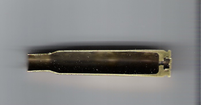

Actually, there is no real need to punch out the primer at all (as long as you make sure it's been fired). ... put it in your scroll chuck or collet chuck BACKWARDS, and drill it out along with the pocket it sits in.
This is a good example of solving a problem by approaching it from a different direction. Drilling from the inside of the case generally works, with a couple of caveats:
  1. The case needs to be boxer primed (see below).
  2. Sometimes the primer anvil gets stuck on (and spins with) the drill bit. When this happens, the bit stops cutting. You need to withdraw the bit and remove the anvil before drilling through.
There are two common types of primers. Boxer primers were invented by an Englishman, and are used almost universally in the USA. Berdan primers were invented by an American, and are often used in Europe (go figure). Boxer primed shellcases have a single hole (called the "flash hole") in the middle of the primer pocket. This is what the drill bit centers on when drilling from the inside. Berdan primed cases have 2 or 3 flash holes off-center in the primer pocket. If you drill a Berdan primed case from the inside, the bit may tend to wander.
Be aware, though, that the flash hole is typically punched. It may not be perfectly centered and often has burrs on the inside. For the best concentricity, you may still wish to drill from the outside, and start the hole with a center bit.

Whew, they look "spent".

you can use a small punch or any think that will go through the small hole on the inside of the case this photo might help

I was under the impression for some odd reason that the web of the average rifle casing was much more conical than flat, and that tended to guide the bit to the center. In the spirit of "a gram of finding out is worth a stone of talking about" I took a unfired USGI 30 cal shell, pulled the bullet, poured the powder down the sink and followed it with a dose of water, wrapped the casing in a paper towel, clamped in a vice with the open end pointing away from anything (including me) put a round tip punch on the primer and tapped it. Moderately loud bang ensued, but as the gas had plenty of room to expand and nothing to push, no other results were observed (or anticipated). I then took said casing over to Mr. Disk sander and removed half of it lengthwise.
A quick scan proved that Eric has a better recall of casing construction than I do. I have however to date not had any holes drilled from the inside of the casing that were unsatisfactory to me in their concentricity. This may however simply be due to lower standards on my part.
Or good drilling technique.
