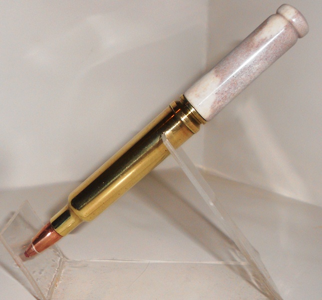

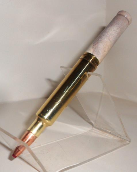

I just did a 338 378 WB Mag with a ballistic tip boat tail bullet about a month ago here is a couple of shots of it. The customer wanted a cross refill so it has a slimline transmission in it. The top is closed end whitetail antler. The lower tube was way short of coming out of the top of the casing but the transmission did so the tube in the upper half was left out by about a half inch so it slid down into the casing to grab the whole transmission. That round makes for a big pen.

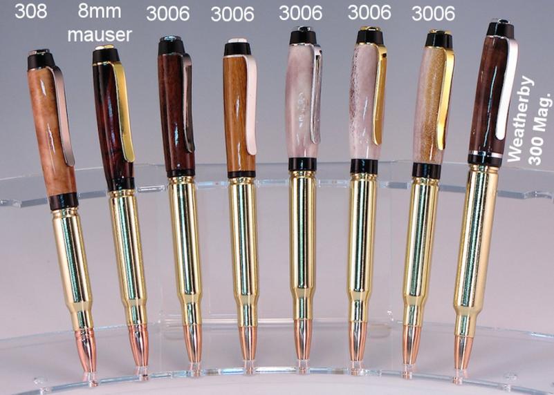

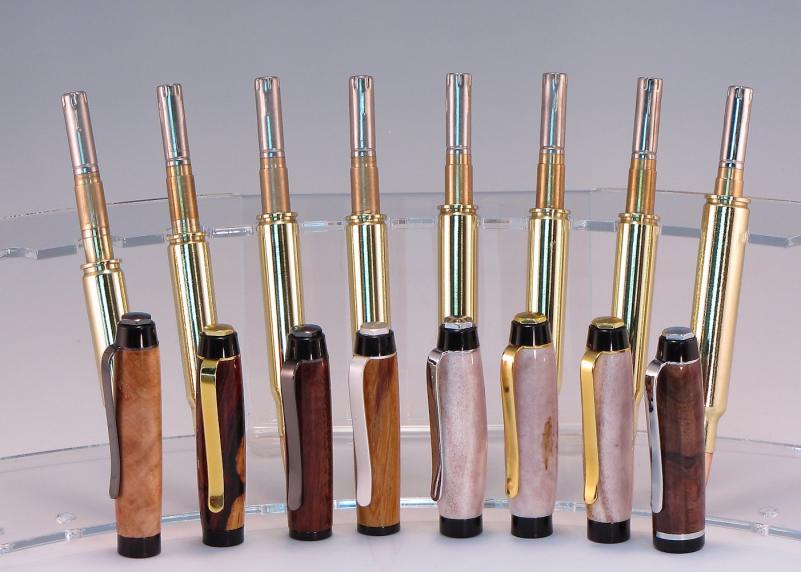

I have done 308, 8mm Mauser, 277mag(not pictured) 3006, and 300 WB mag, all using cigar components. The following two photos may be helpful in how they were configured.
Not that each has a center band, it is required to "neck down" the bottom of the cap to prevent it from "flopping" around. All but the 300WB are hand turned, it uses the standard cigar center band.
