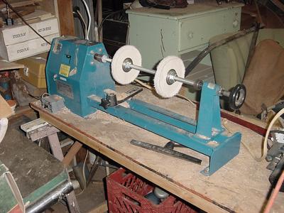

Originally posted by its_virgil
<br />Here is my first lathe converted to a buffer. It works great and didn't cost much. I have since added a 3rd wheel.
Do a good turn daily!
Don
<br />
tipusnr
May 15, 2004
1,692
Reynoldsburg, OH, USA.
Now THAT's a good idea. I have a Harbor Freight lathe in the garage acting as a disk sander as the tailstock is bad. Never thought of bringing it down to the shop for a dedicated buffer!
