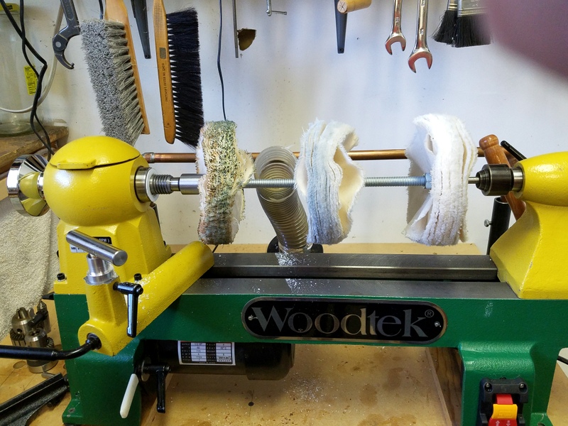

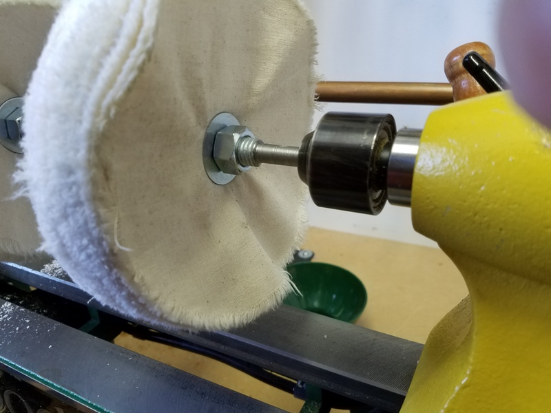

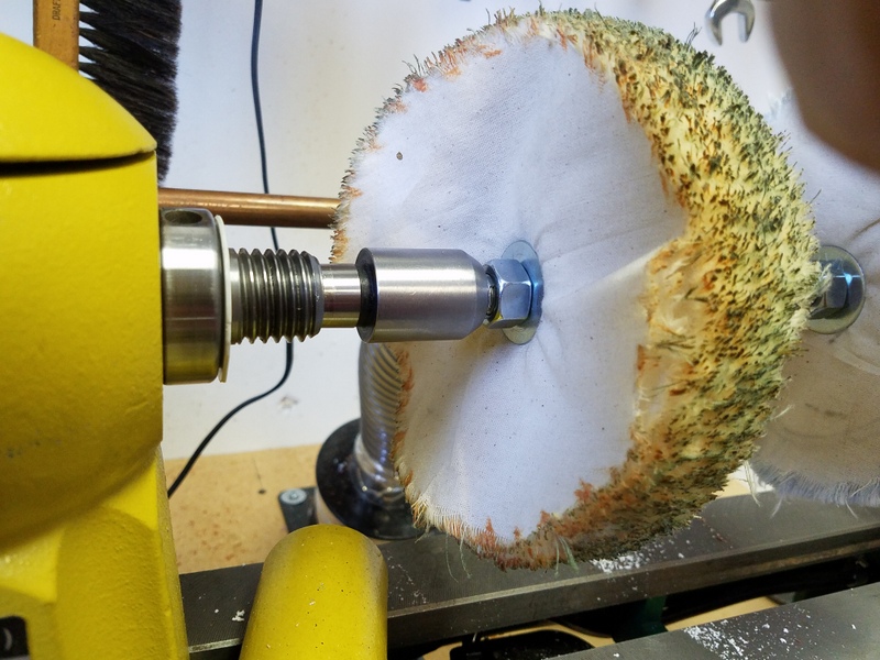

The photo is of my buffing system. I had originally made it for my Record Power Lathe. It had a M1 taper and the lathe length capacity was a bit short placing the buff wheels too close. I remade it 15" using a M3 3/8" end mill holder in the head stock and 60 degree on the tailstock end to fit a live center. All three buffs are cheapies from HF. I think I really need at least one sewn wheel.
