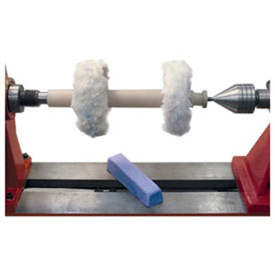

I'm thinking about some type of buffing system.
Would it make acrylic blanks look much different than polishing w/blue towel and one step?
Can you polish wood, Pens Plus, with the same wheels...or do you need another setup for that? And how much difference would you see?
Can you "spruce up" an already made pen without having to dissassemble the thing? Like one that hasn't sold for 3-4 shows and looking a little dull.
something like this...?

As a last step after micromesh, I buff every pen finished with CA and every resin pen. I use the system you linked in the first post.

Buffed half with the Barry Gross 2 wheel system in your photo and compared them under a bright light and 10 power magnification and I could see a difference. I could also feel a difference.

The buffing system shown above with two tiny wheels is junk to me. I bought it so I know I made a mistake. I have two Beale buff systems with three large quality wheels - that rocks! For CA and acrylic I only use the first wheels. I have learned the wax makes pens hazy the next day and days after that. Why sell pens that look good only today.
