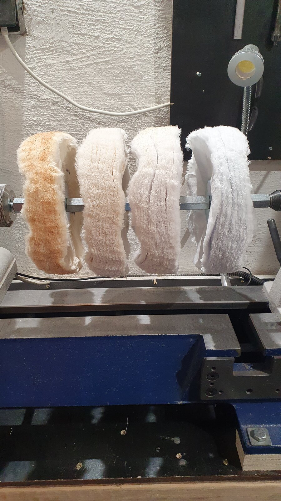

I've decided to make the 4 wheel buff because it really makes sense and I got a plastic buffing compound from axminster and I can actually see a difference a pretty big difference in shine and less scratches 👍
