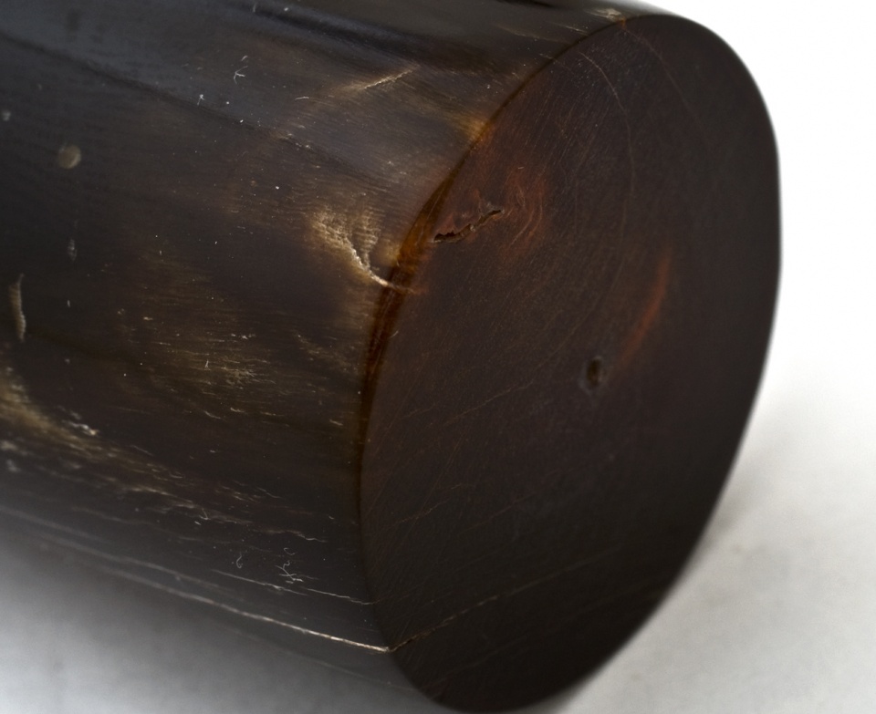

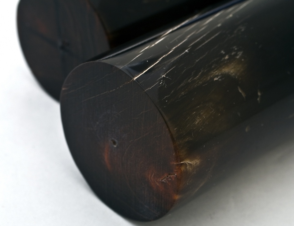

Seriously tho, the first one does have some pre-cracks, the other 2 are about as good quality as you can get. Even tho the first one has pre-cracks in select areas the working on that is up there so there is great potential in it, so far anyways.
Ed, good luck. Cracking on hair horn, as Buffalo horn is keratin, the same substance as hair and nails will cause them to crack, as with things like snakewood, gator bone and others not all will but they are prone to crack.
