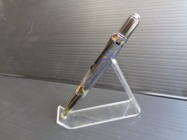

This is one of my 4 Buffalo Horn Pens that cracked.The PSI Disasembler works
