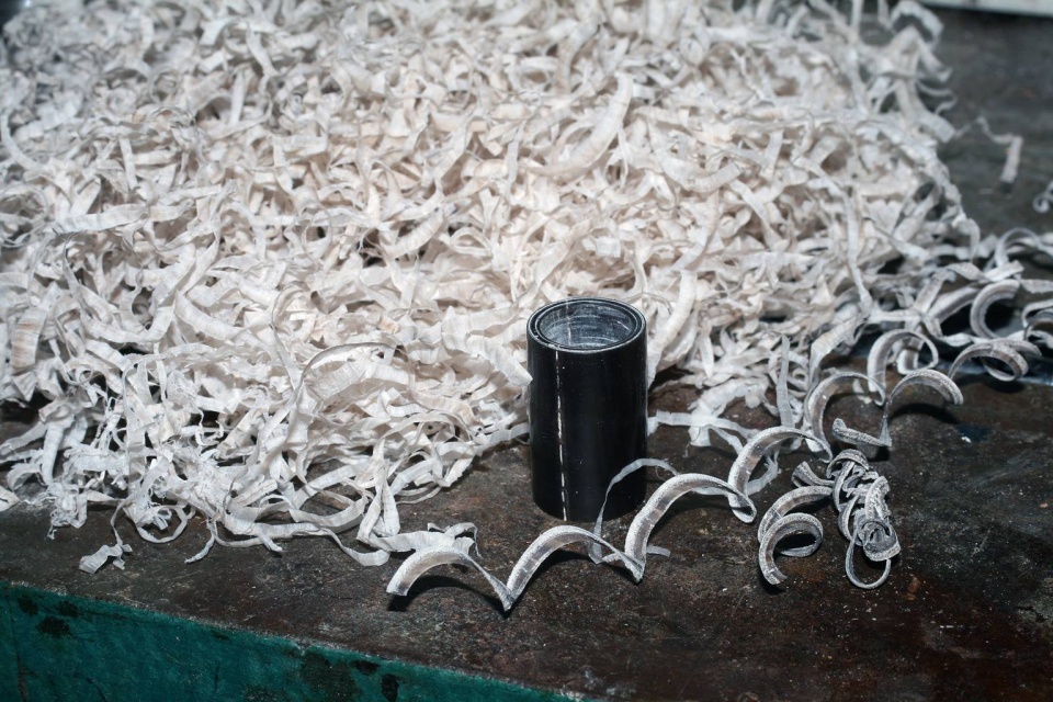

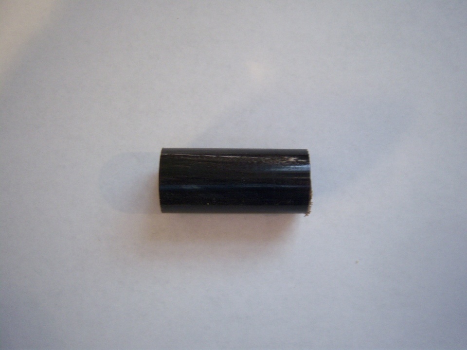

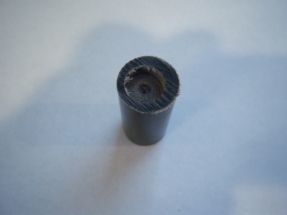

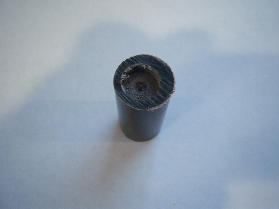

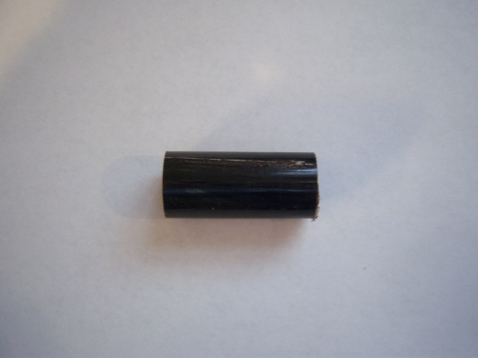

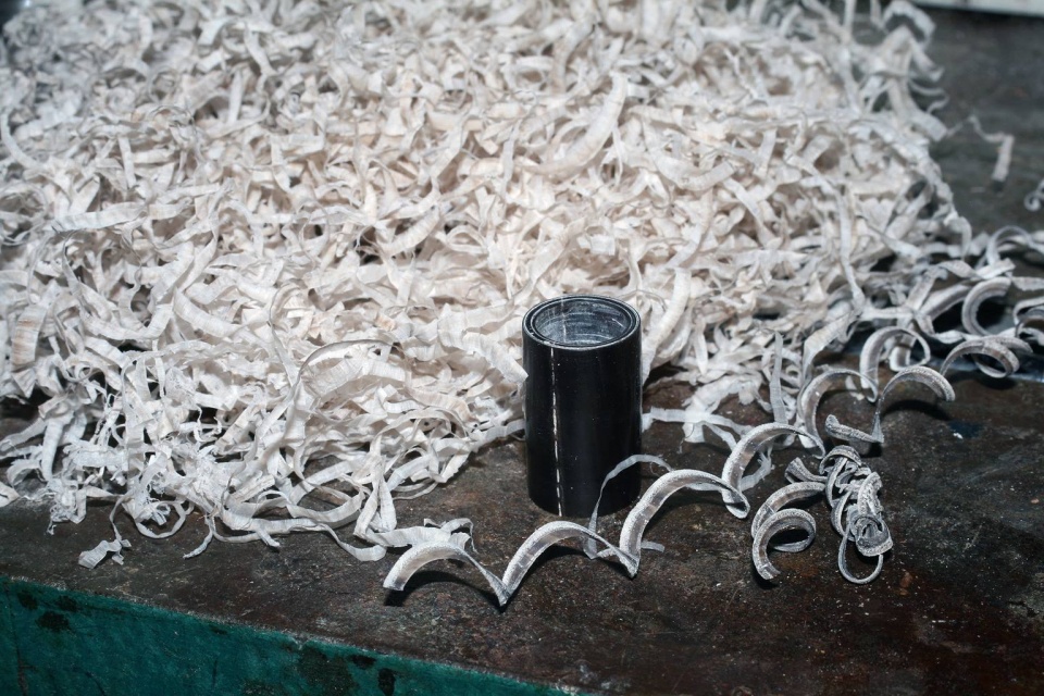

I've never used buffalo horn before and have read up on the properties and hazards of turning, but started to drill and had a result I didn't expect. Once I got past the initial 1/4 inch or so it started ribboning like an acrylic. I got this in a mixed assortment of blanks and it was labeled buffalo horn but I'm wondering if it isn't an alternate horn or other material? I expected it to drill somewhat like antler which I've many, but the other thing was the odor was horrendous, like nothing I've ever drilled or turned before. Here's a couple pictures if that helps? Thank everyone in advance for any help! Oh and if anyone wants to know my secret to perfectly centering the hole let me know:rolleyes:
This means you damaged the horn. This comes from over heating the horn and it is a very reactive material so expect it to change shapes, meaning it will move and therefore crack because it was over heated.
...drilling and cutting smelly horns is "usually" a result of cutting fresh horns, non- aged as in length of time that they were surrendered from its' host. DAMHIKT
